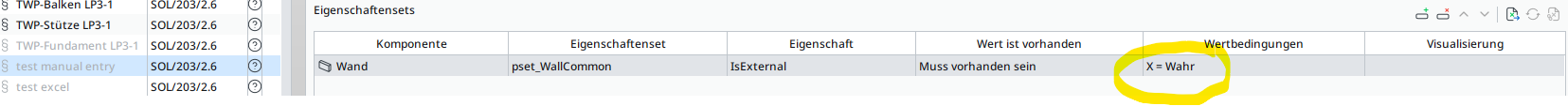

    • Test operational feature by loading a manual entry with a boolean value that must be True, like this:

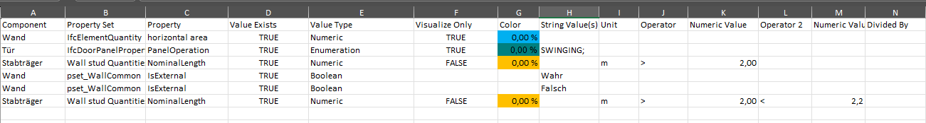

    • Test not operational feature by loading the “True” value from excel. I used the standard template out of the box:

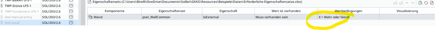

    This never sets to “True”, it results always in “True or False” (any value):

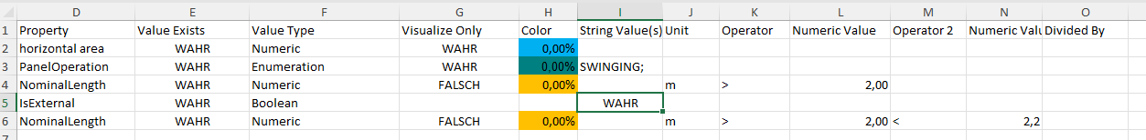

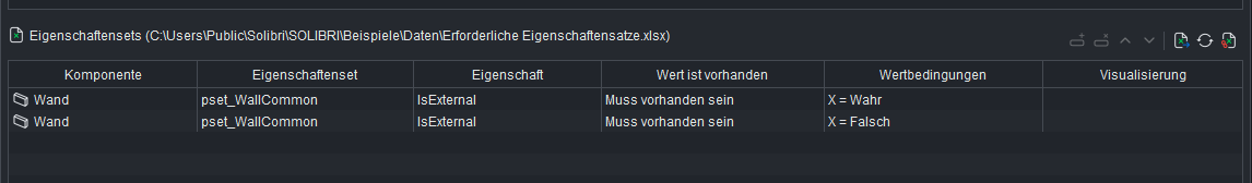

      The German Excel example for this rule has a problem.
      The true/false value in Excel for German Solibri needs to be as Text “Falsch” or “Wahr”. The Excel boolean value is not working.
      Here is the fixed example.
      Erforderliche Eigenschaftensatze.xlsx
