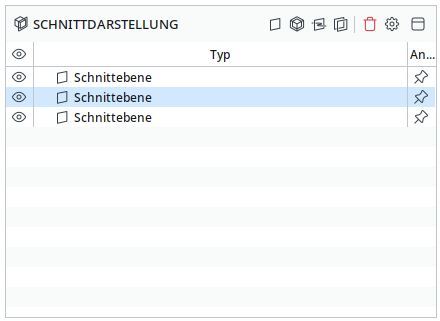

      Hi Toni,
      simply said, it feels like working on an 80386 machine when trying to move a section plane 😉
      In 25.12 everything was fine. Now it is interrupted and feels like bubble gum. While moving the section the program needs nearly 50% of CPU power. What does it do in the background? See the two files attached, I can’t work with this.
      It seems that it has to do with checking. After opening a file it runs like expected. As soon as you clicked a checking result, Solibri goes to “slow mode”. After that even deleting all rules does not change anything until an app restart.
      Regards
      Hartwig
      25.12.mp4
      26.6.mp4
      BvanDalsumB 1 Reply Last reply

        Thanks @Hartwig for the videos, this doesn’t look at all as it should. We haven’t seen such degradation in our test models but we will dig into this right away. You wouldn’t perhaps be able to share that model for testing purposes would you?
        HartwigH 1 Reply Last reply

            @Hartwig @tonigyllenberg
            This is exactly what we’re experiencing.
            It’s already a lot faster than in version 26.4, but it’s certainly not where it needs to be to make working with the models a pleasant experience.

                    So we’ve done some more digging. Indeed 25.12 is faster for a few reasons, but the most important reason is that it does not include any of the newer options regarding grids, sections and markups.
                    Our Lead dev has spent some time Friday optimizing the sectioning performance altogether and with the release we’ll have an overall better performing sectioning tool.
