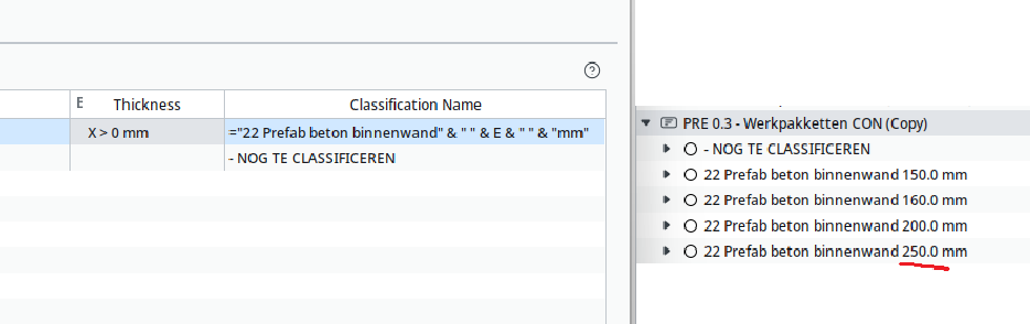

How to remove a decimal when using a formula?

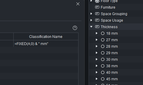

Unit settings control display formatting in tables and reports, not how numbers appear when you concatenate them in a classification formula.
To remove the decimal in the classification name, you could try to wrap the thickness reference in FIXED(E;0) or INT(E) in your formula.
Hope that helps!
@jakub-rusin That works great, thanks!
