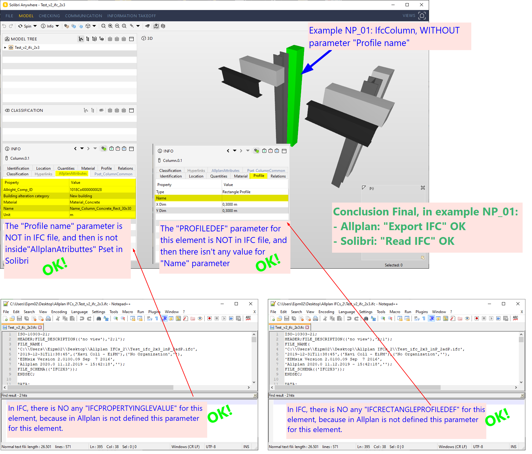

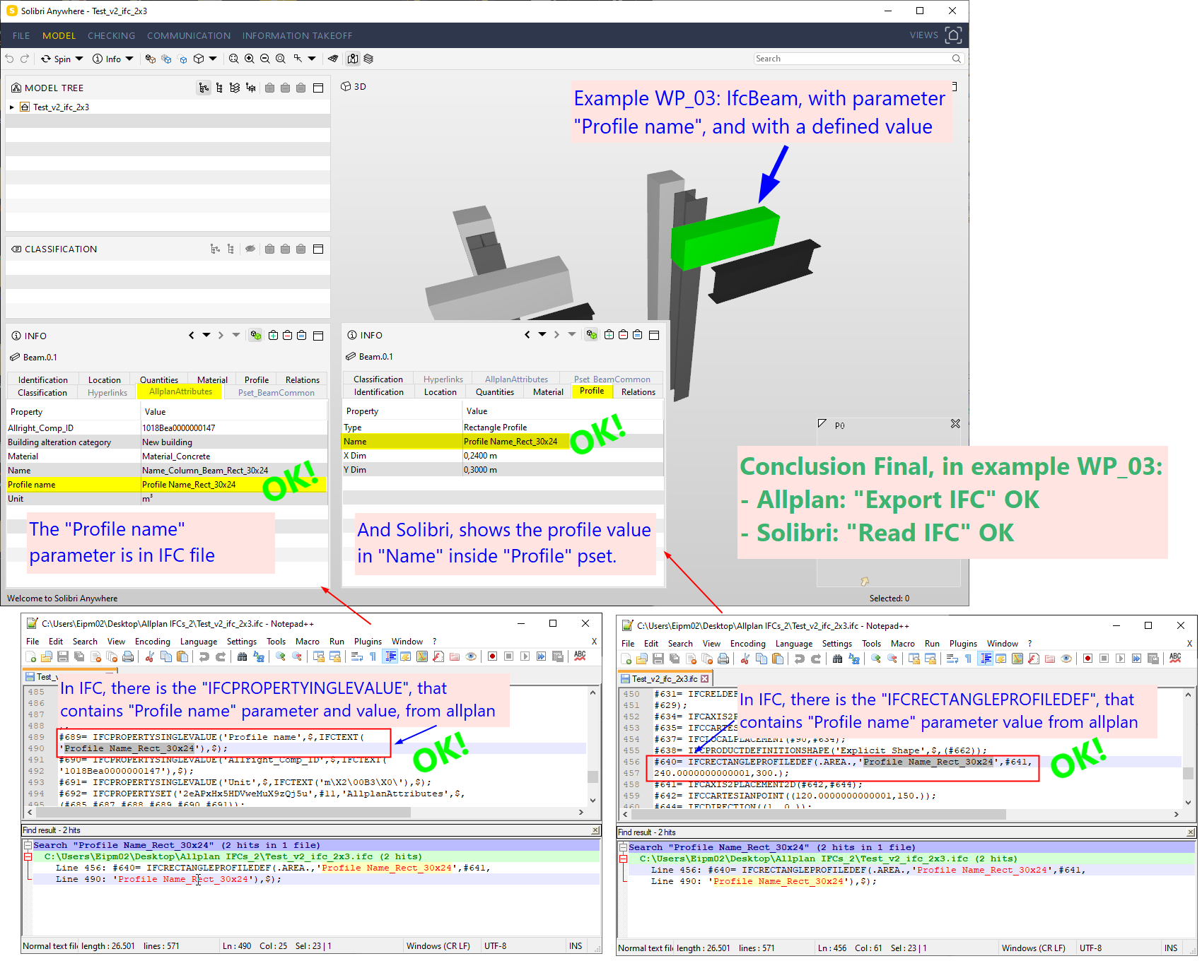

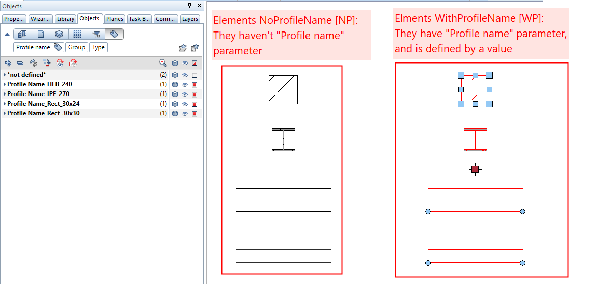

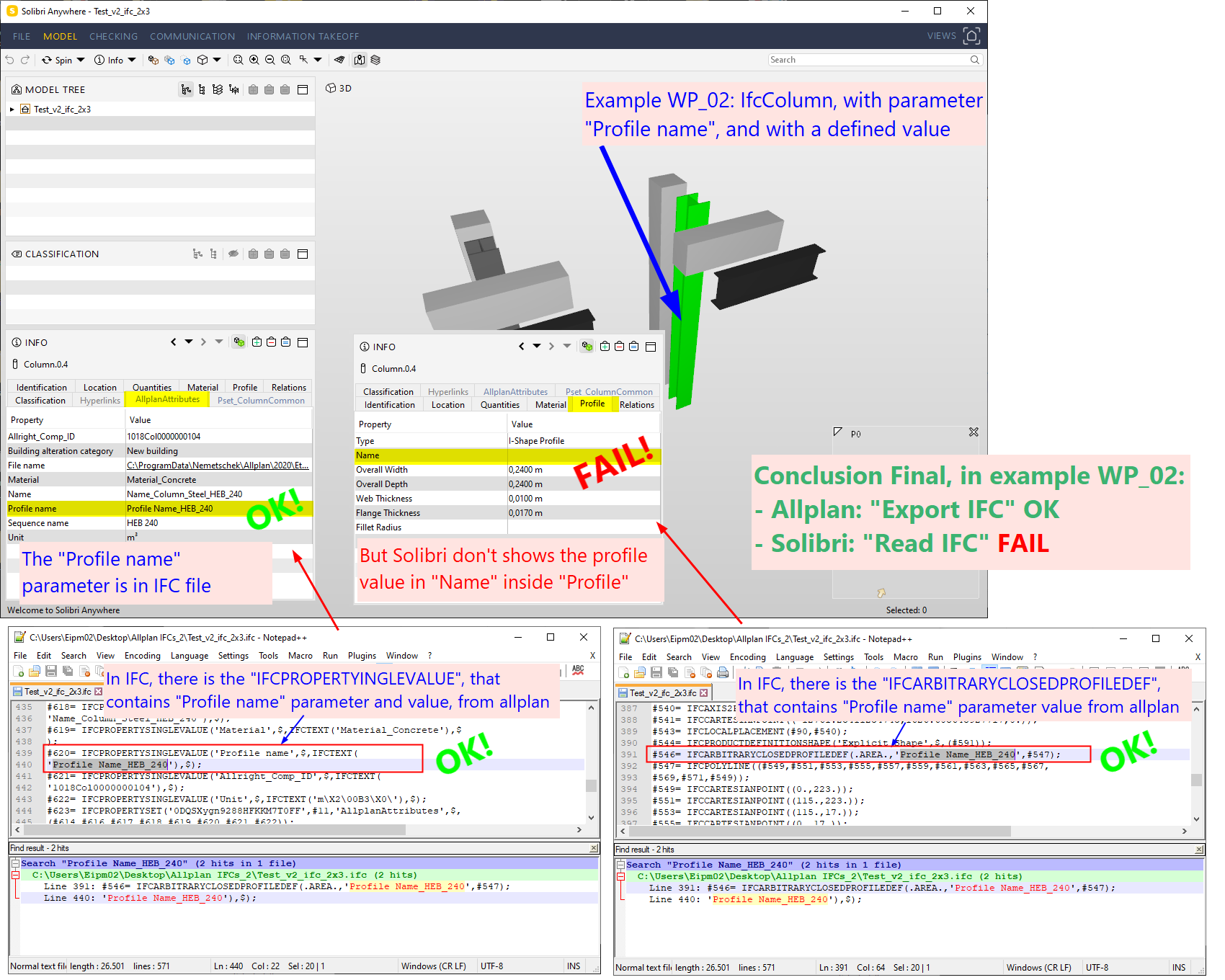

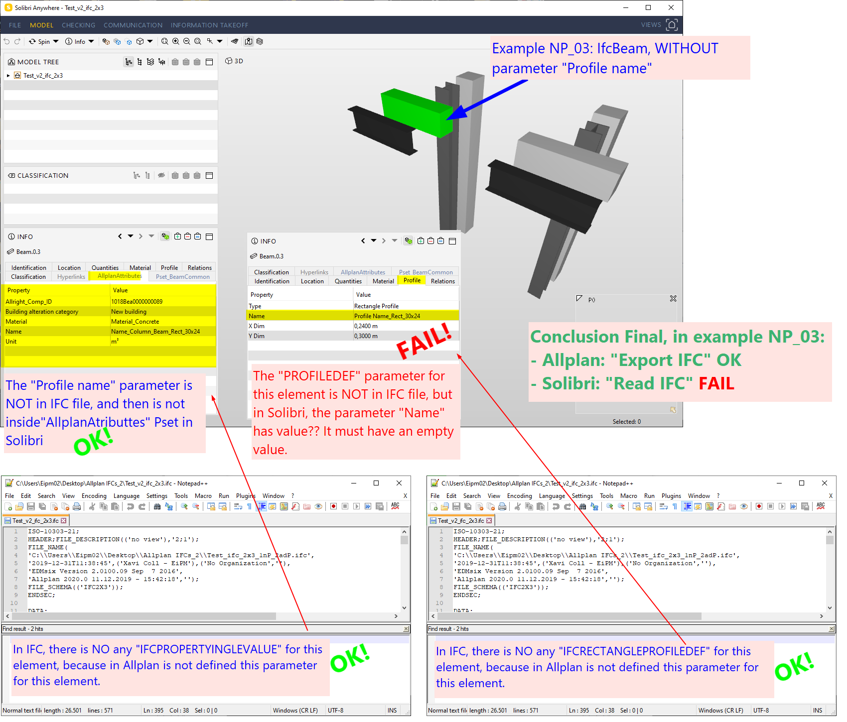

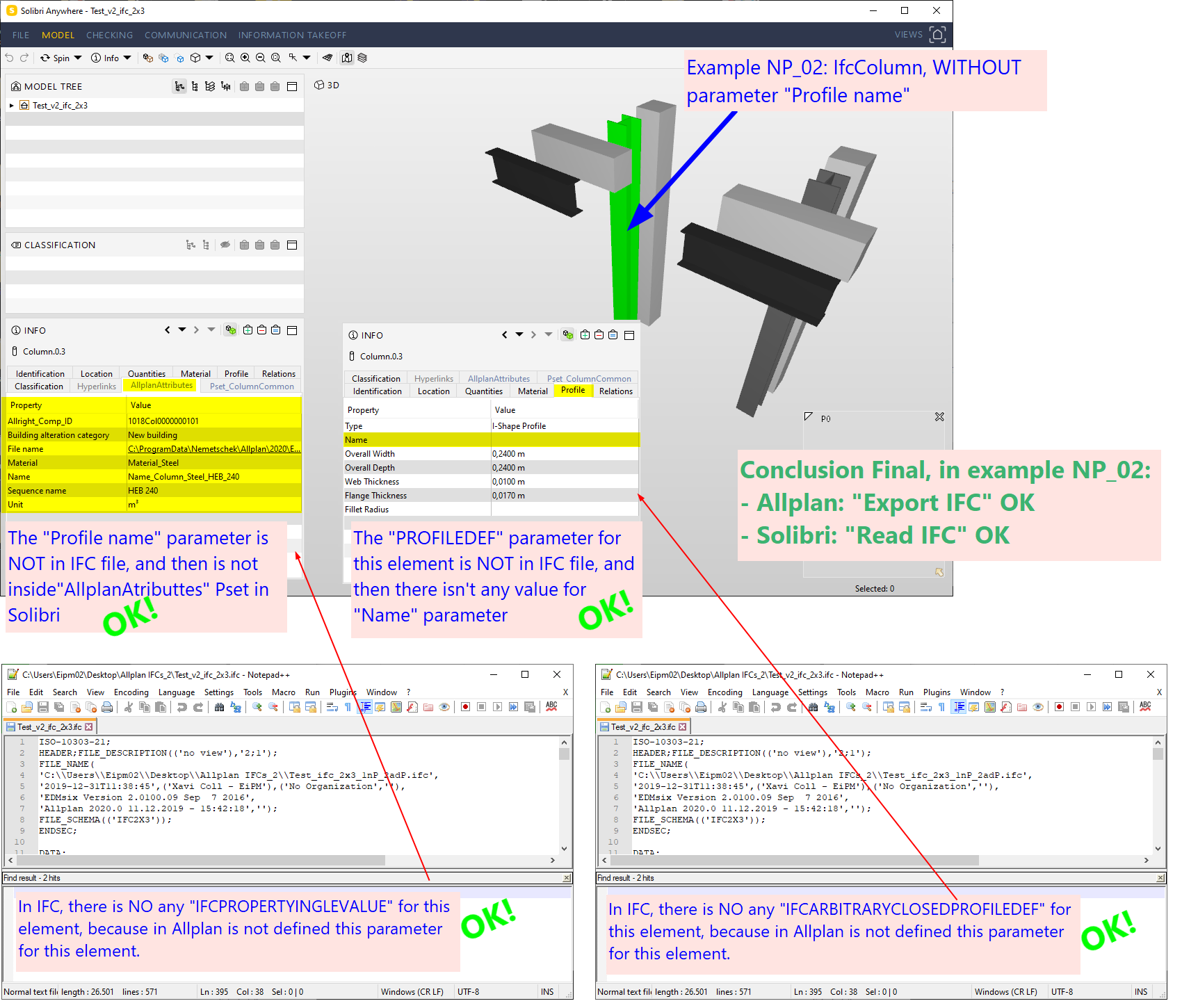

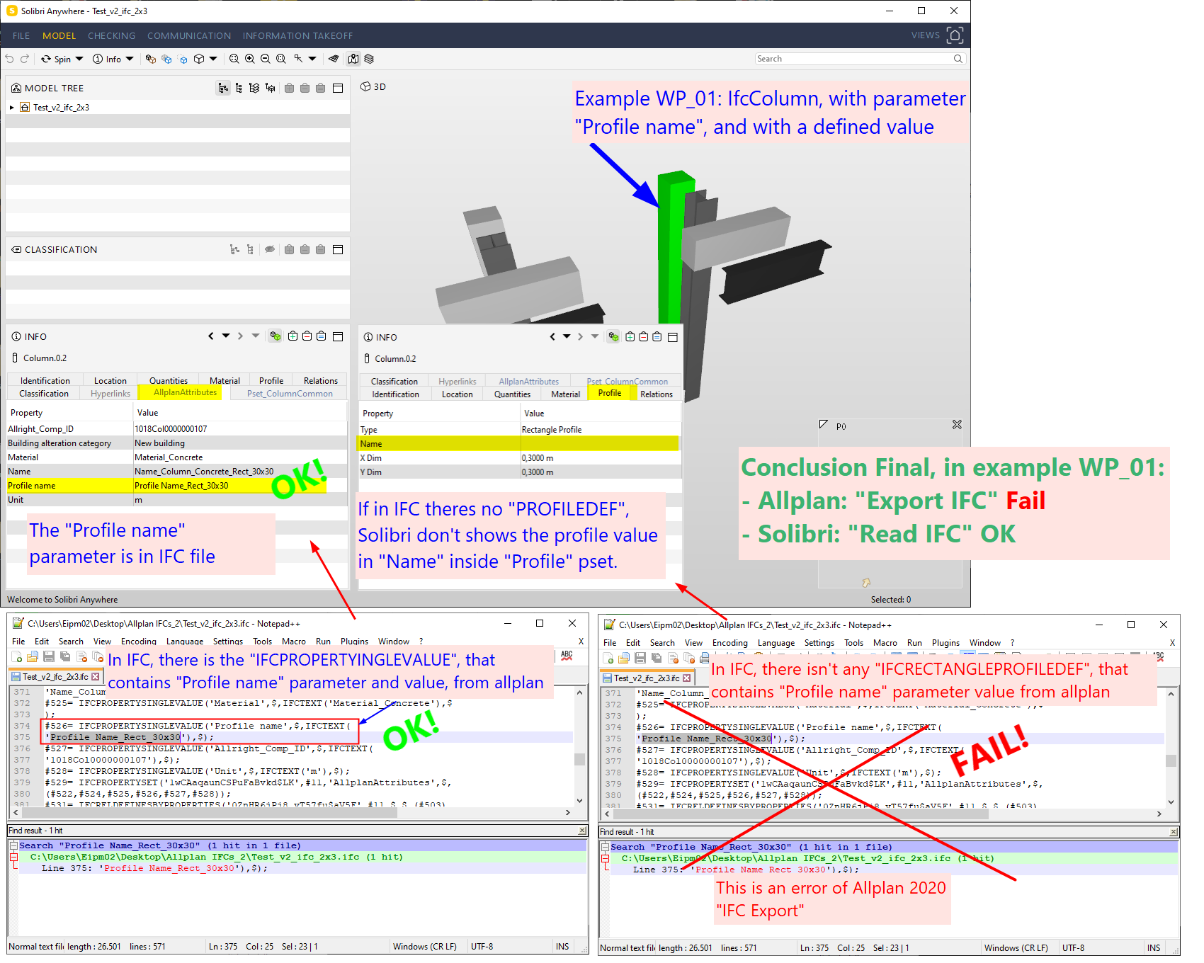

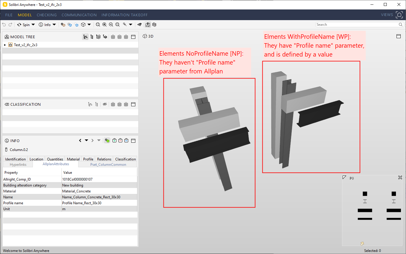

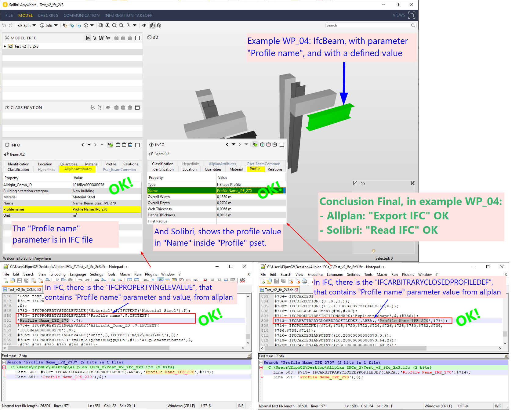

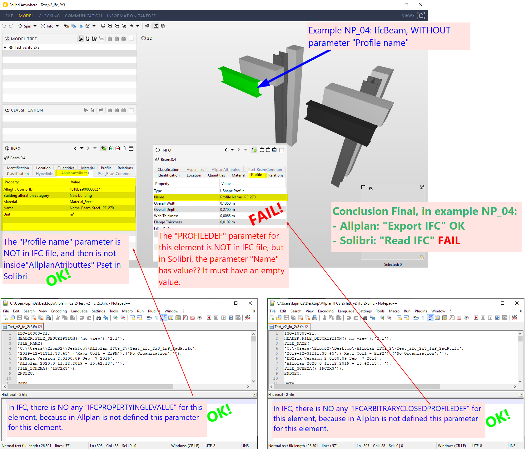

        I upload another IFC 2x3 file, to explain the “Profile” issues.
        1- Scenario:
        1a - Screenshot from Allplan:
        2a - Screenshot from Solibri:
        2- Screenhots about test results (some ok, some fail)::
        Example WP_04.png Example WP_03.png Example WP_02.png Example WP_01.png Example NP_04.png Example NP_03.png Example NP_02.png Example NP_01.png
        I attach the IFC 2x3 used.
        Test_v2_ifc_2x3.ifc
        Best regards!
        Xavier Coll

          Hello again @Xavier,
          Thanks for clearing that up. I will file the issue today and we’ll have a closer look at this.
