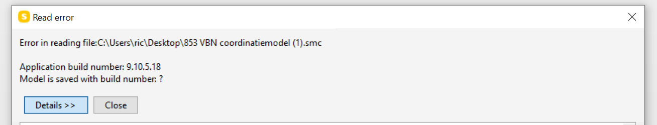

    We get a read error on a .SMC file since this morning (on multiple machines). Does anybody knows why this is happening?
    ( also happens on a machine with the latest release 9.10.6.23)
    java.io.EOFException: Unexpected end of ZLIB input stream

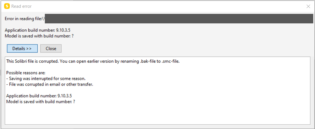

    • JeroenKoomenJ Offline
      JeroenKoomen
      This looks like an End of File missing.
      Propably the file was not saved completely.
      Have a look at your back-up file. If that file is larger than the smc it is likely that it was not saved completely.
              is an indication that part of the file is missing from the filesystem. It also usually means there is nothing that can be done to recover it, unless you have the backup functionality in use and that the backup file is not corrupted.

                @JeroenKoomen said in .SMC file Read error:
                This was indeed the case! Thanks. I changed the backup file to .SMC and that worked.

                Toni, unfortunately I can’t find a log-file in the folder where it should be located. Could it be possible that this file wasn’t made?

                Agroni, try changing the .BAK file to .SMC if that helps for you.

                  I have looked for my SMC backup file, but cannot find it in the original folder! Reasons??? Is it also stored somewhere else?
                  If I don’t find this backup file, I will loose only 6 days of work which might not be a lot… but… I will loose more then 70 documented issues! 😕

                          Dear @Solibrians,
                          more and more issues are appearing with this “new” phenomenon of not being able to open the previously saved files. This is not a strategy, that in my opinion Solibri should follow. Users will have tons of lost hours and if also maybe days if this will continue happening.
                          I understand if a crash happens during working, that a software can report errors. In this case the user should have the possibility to restore his data from an autosave (which is requst to Solibri to introduce: see also Autosave and Backup by @Tamas-Kurucso). But a total No Go is the scenario where a user consciously saves the file, goes to sleep and the next day he gets an error… and he drops the mug with hot coffey on the floor from his shock.
                          Therefore in my opinion, the Software should not allow saving a file, that it is not going to be able to open the next day!
                          I hope you agree on this one with me…

                            #13
                            Hello!
                            We are aware of the issue and are currently looking into it. This is precisely reason we ask for log files to get as many details as possible, so that our developers can pinpoint the issue at hand as fast as possible.
                            We agree that this behaviour is not acceptable. Currently, it seems that these issues stem from problems during file saving, and we are considering adding an additional save check and/or error message in case of any problems with saving, which will prompt the user to save the file again.
                                I also get this.
                                Attached my logs.runtime.log error.log gc.log output.log
                                Maybe i was to quick… and this had to do with a slow network connection.
                                Copied to local and it opened… sorry to confuse you guys 🙂
