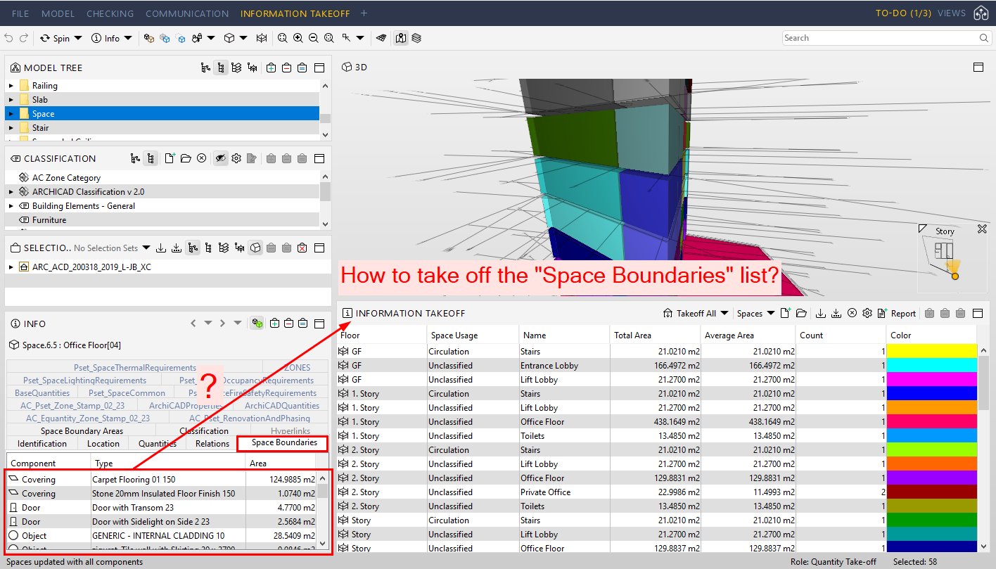

    How to do a Information TakeOff of the areas from “Space Boundaries” pset of spaces (no the “Space Boundary Area” pset) ?
    IN our internal research, we can do this:
    • We can do a ITO that list Spaces and his relation “reference” of the walls, floors, ceilings, and so on.
    • With this list of spaces, solibri can show the area of those elements (walls, floors, …) but is the area of the element (wall, etc…). But we need the area in touch between a space and the elements (and it’s exactly the information that is showed in “Space Boundaries” pset).
    I upload an image to explain it.
    Best regards,
    Xavier Coll

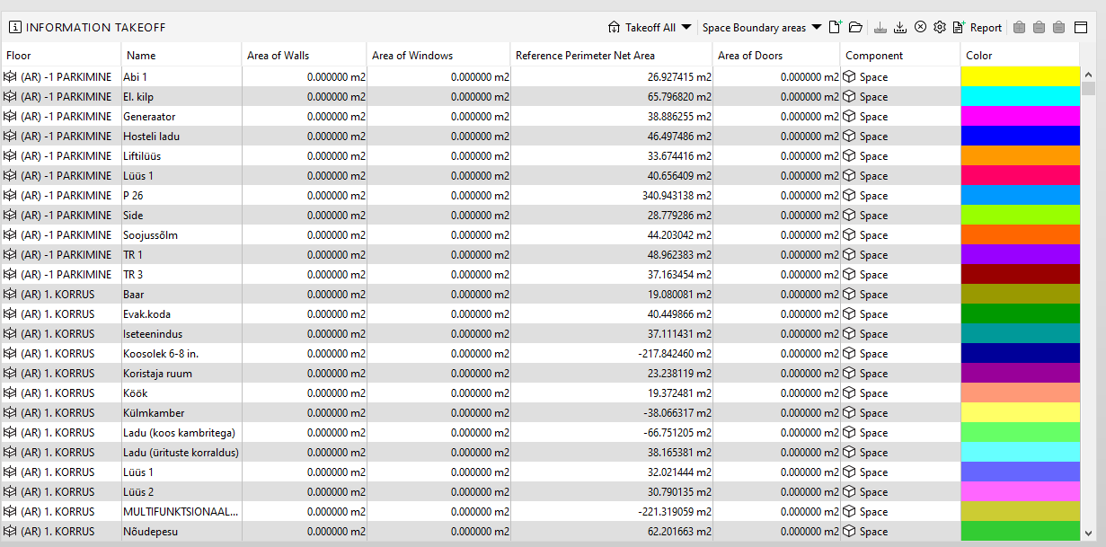

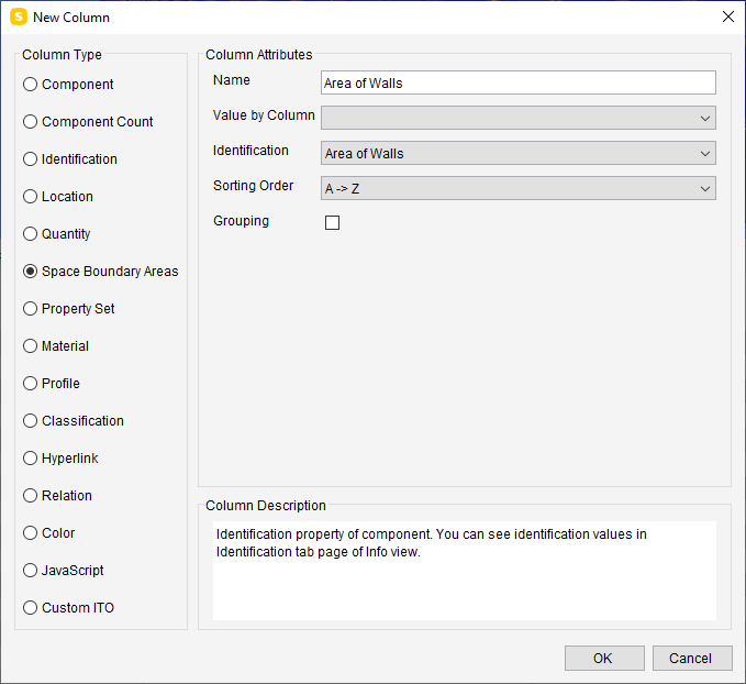

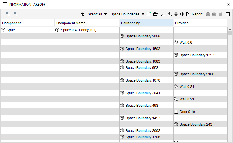

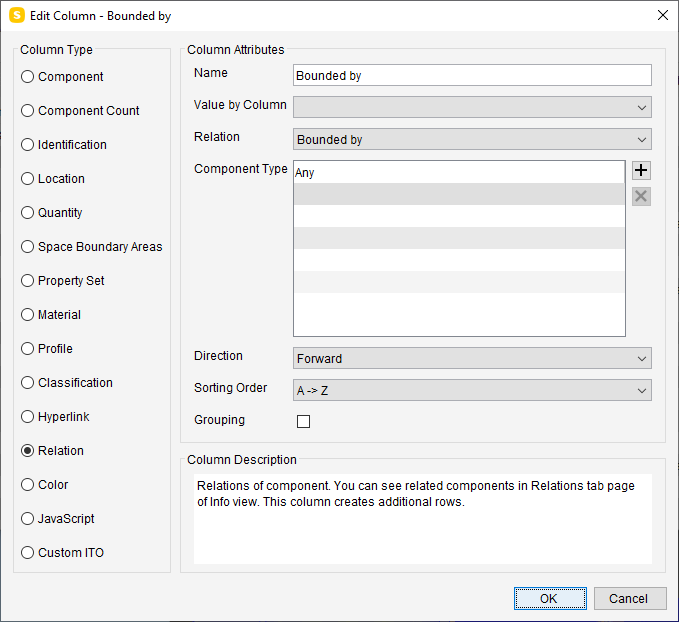

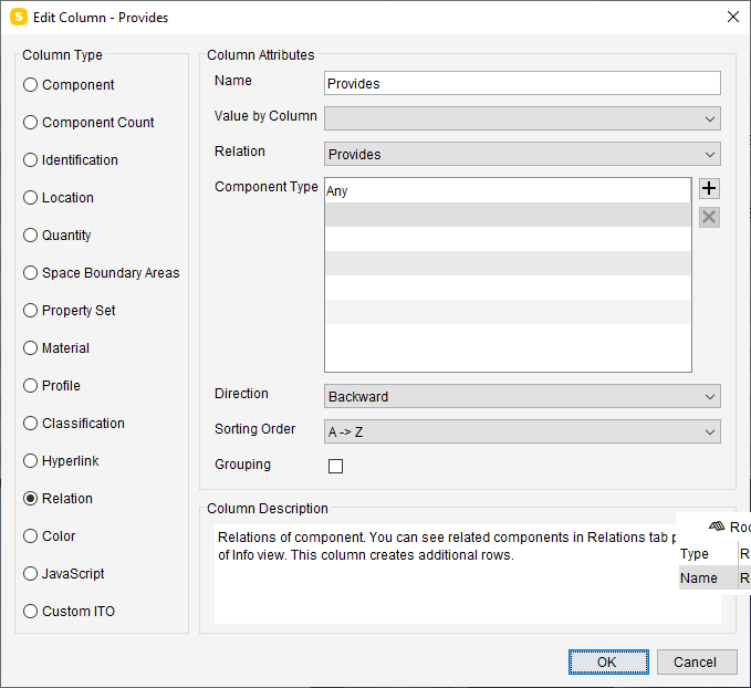

      There are two ways to do this in ITO. List spaces and use following ITO columns:
      1. Using space boundary areas column type:
      1. Using two relation columns:
        [0_1584717314103_Space Boundaries.ito](Uploading 0%)
      3
      • XavierX Offline
        XavierX Offline
        Xavier
        Thanks a lot @Matti-Kannala ! It works for me

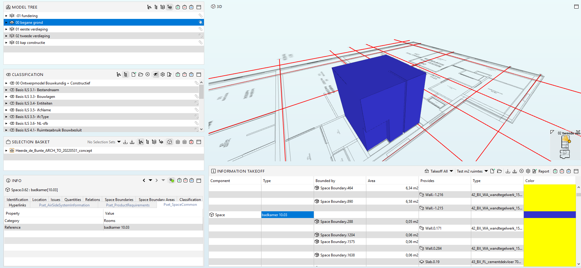

          I cant get it to work. What am I doing wrong?
          My result
            lraimo
            Seems that problem in somewhere in IFC model because in another model it is working.

              But is there a way to get not emty cells?
              Now I have can’t do anything with the m2 in Excel.
              JSNJ 1 Reply Last reply
                replied to Sander E on last edited by JSN
                @sander-Eikelboom Not really without having all the references you need. Anyhow you could use Power Query to postprocess and format your lists accordingly in Excel I guess …
