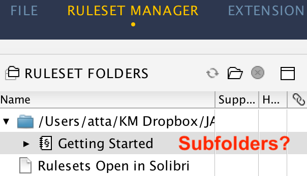

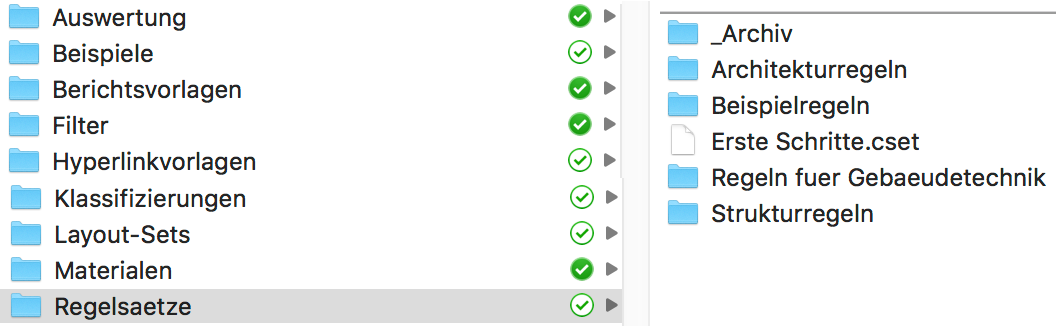

                      Problems:
                      Ruleset Manager: Editing Rulesets trial and error. Where are the rulesets?
                      Example: I [the unexperienced user] launch Solibri. I don’t have any model open. I have a Resource Root Folder set up copying parts from the Application folder, this is it’s content:
                      In Ruleset Manager I don’t see any subfolders:
                      In order to see the subfolders, I must navigate the folders one by one.
                      Expected: upon clicking on the Rules Folder, all there included subfolders are pre-loaded.

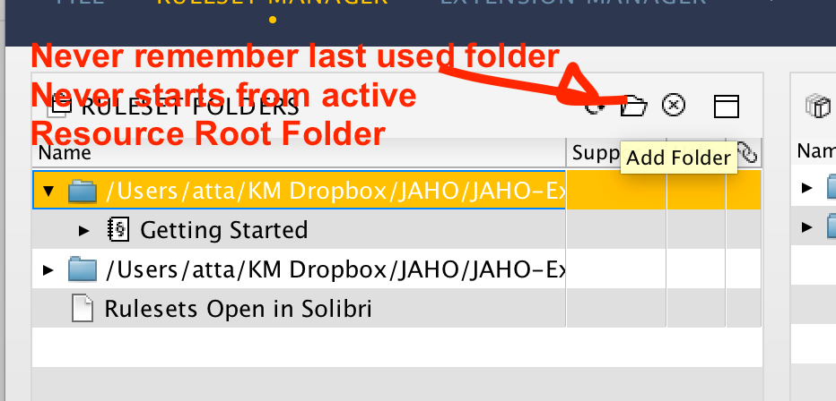

                        Problems:
                        Ruleset Manager: Clicking on the folder icon always open the Application folder
                        Upon navigating for folders Solibri always ignore the user defined Resource Root Folder and goes back, again and again, to the Application folder.
                        Expected: we start either from the last chosen folder, or from the active Resource Root Folder.

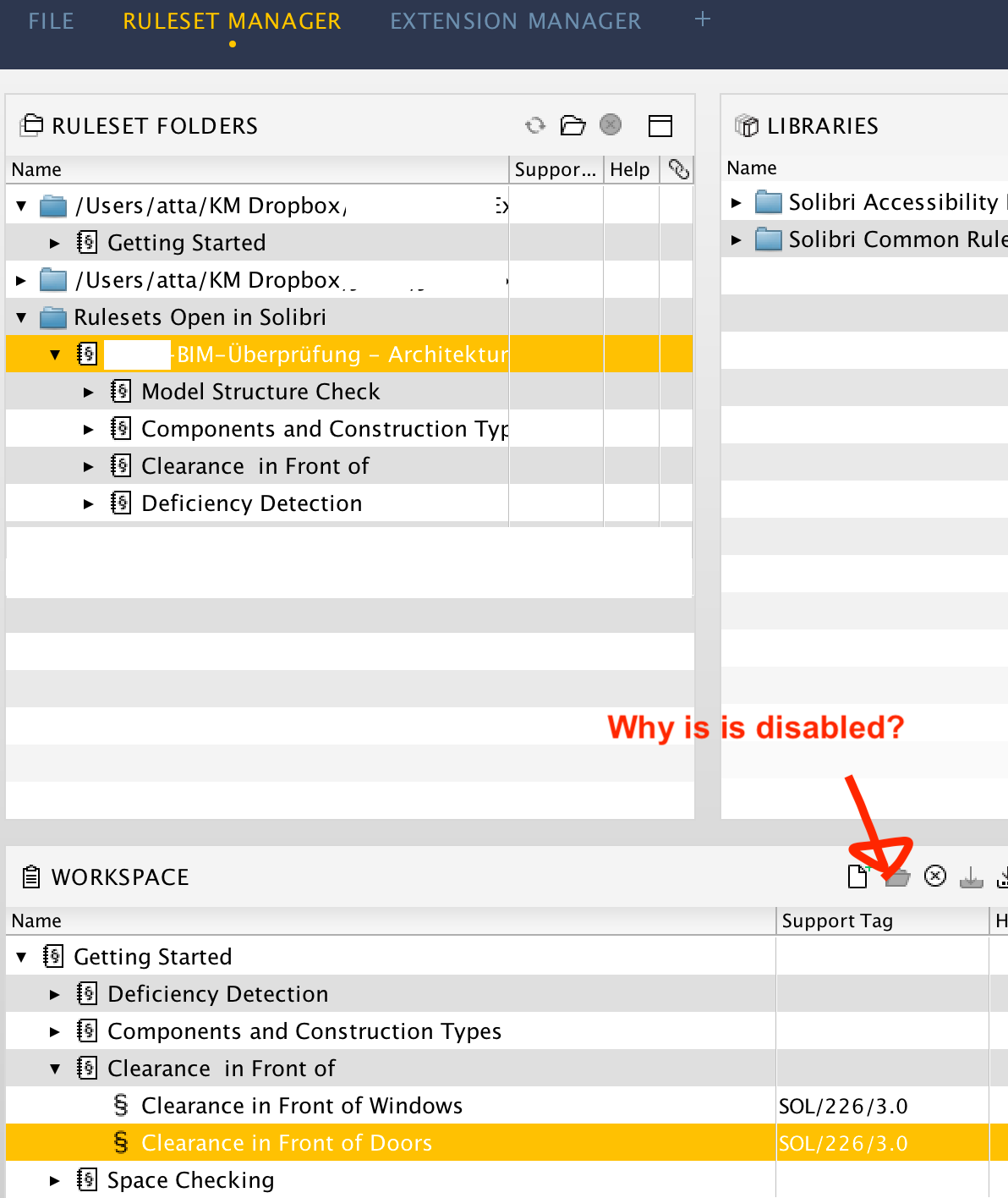

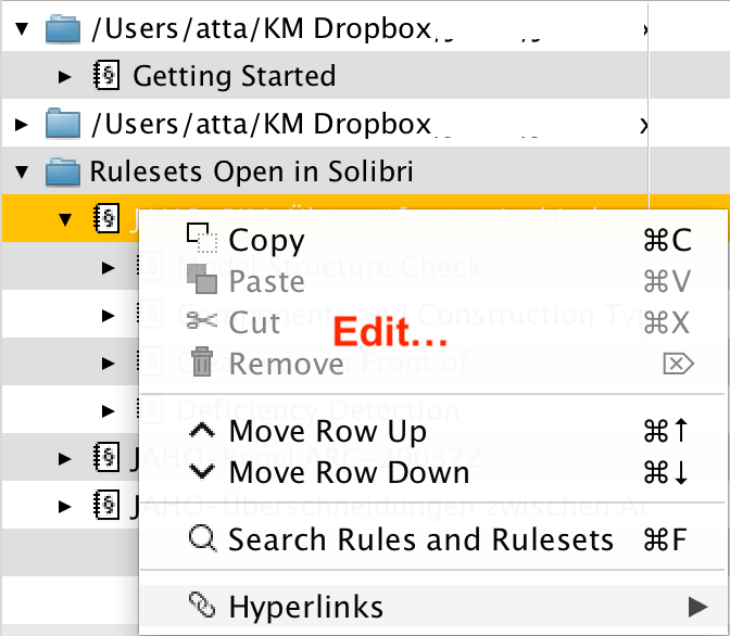

                          Problems:
                          Ruleset Manager: “Edit” option in contextual menu?
                          For editing a ruleset file, the user must click on a folder button, this opens the chosen ruleset file in the Workspace below.
                          For editing another ruleset one must click on another button, a cross one, to remove the previous selection from the workspace, then again click on that folder button.
                          If you don’t remove the previous selection, the folder button is disabled. For a long time I quit and restarted Solibri just to be able to edit another ruleset!
                          This is quite counterintuitive. Why a folder button? Why removing and re-adding?
                          Expected: “Edit” option in the contextual menu. This could open the selected ruleset in the workspace, closing any eventually open ones. Prompting for saving any changes.

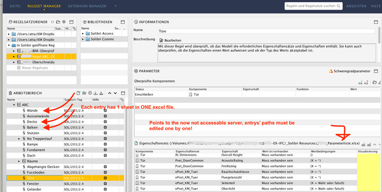

                            Problems:
                            Ruleset Manager: rules loaded through excel files store path as absolute
                            We have a rather extensive list of parameters to be fulfilled. We store them in 1 Excel file, 1 sheet for each ifc entity.
                            But now that the path to the server has changed, the path is invalid: each element must be edited singularly. This is rather maddening.
                            This is particularly annoying also because Solibri doesn’t remember the last chosen folder or its own Resource Root Folder.
                            And since we are suddenly on Dropbox, everyone of us has a different path! So we are not in the position to edit the parameter list any longer.
                            Expected: path to one file can be changed in one place. The path is relative.
