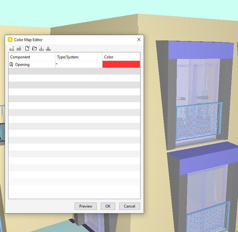

      Hi Simo,
      You can visualize openings by adding a colortable to the model and overwrite the color of all openings to a desired color.
      • Simo_ZS Offline
        Simo_ZS Offline
        Simo_Z
        @JeroenKoomen thank you for the message. I tried what you suggested but I still have the same problem: the openings still not visible.
        • JeroenKoomenJ Offline
          JeroenKoomen
          Sorry… i was convinced that would work… but it does not. Strange…

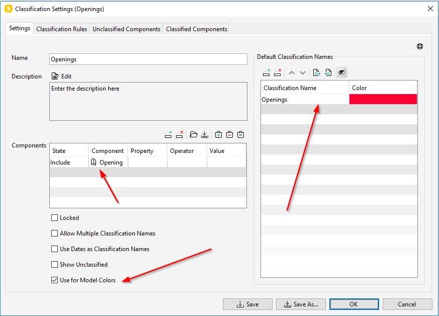

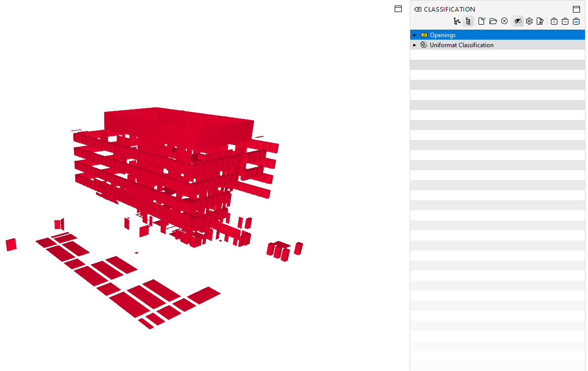

          Another option… i tested this one. 🙂
          1 make a classification of all Openings.
          2 Use classification to color the openings.
          Hope this helps…

            Thank @JeroenKoomen!!! I tried also this system and it’s working quite well.
            It’s a petty that the Color Map Editor doesn’t work for the opening!
