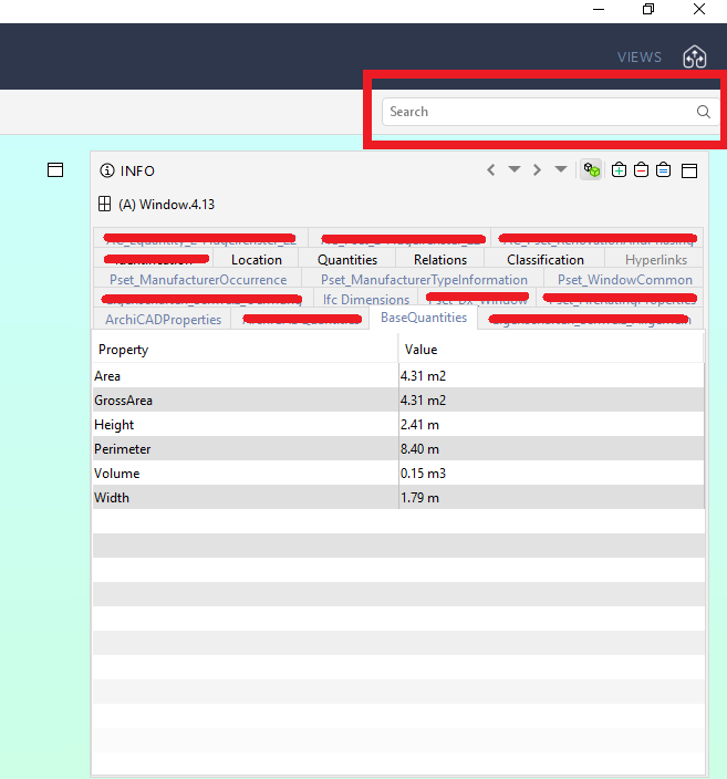

I am trying to find a way to search a Parameter name in the model. Is there a way to use the search tool and look for a parameter name?
I have a model with a lot of Parameters and for some reason they exported the model with the wrong mapping/set. I would like to get the location (Property Set Name) of same parameters name.
I tried to use the Filtering tool but, in this case I got the elements that contain or have that parameter name but not the Property Set Name that contain that parameter.

I do not understand the question.
You have propertysets. A propertyset consist of several properties… each property has a value.
What do you want to search?
@Simo_Z said in Search Parameter:
What do you mean by filtering tool? The one you higlighted is the searchbar.

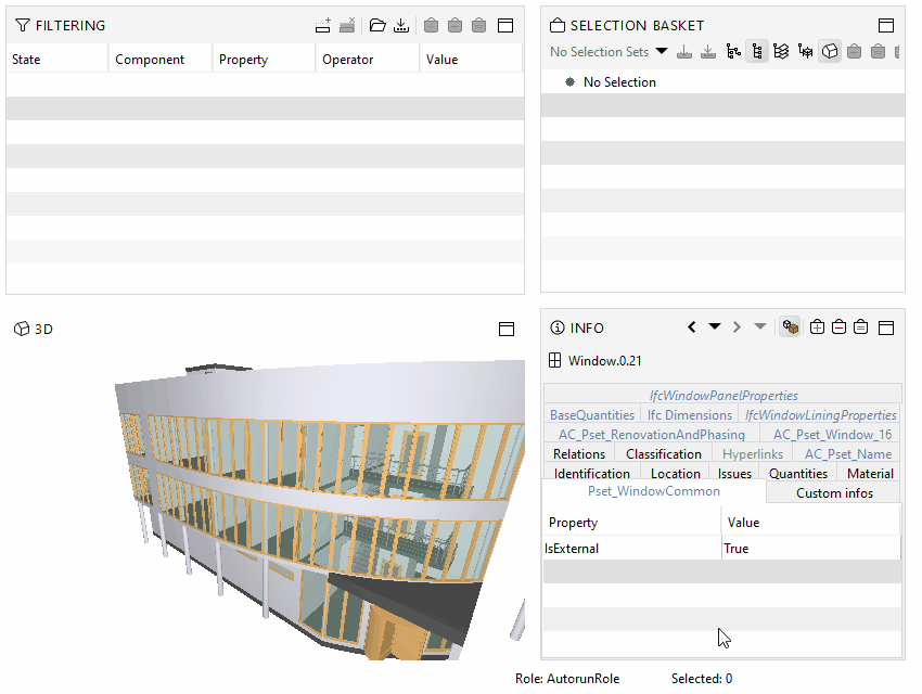

Using the filtering tool you should indeed be able to find what you are looking for:
Hey @Simo_Z,
I guess @JSN already gave good advice with using the Filtering Tool for your use case. Just a small additional tip: You can also use wildcards in the Filtering (same with the classifications) to search through all the PsetNames the components might have. Here a quick video:

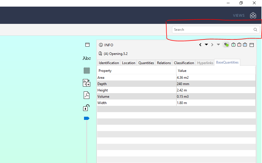

Good morning all,
thanks for the answers, what I am looking for is the way to search a parameter name instead of the value of one specific parameter.
For example the Parameter “GrossArea” and to get the location “Propriety Set Name” in this case BaseQuantities
I have a project with a lot of parameter and I was thinking that could be nice to search the Parameter Name in stead of going label by label and scroll the full list of parameter.
