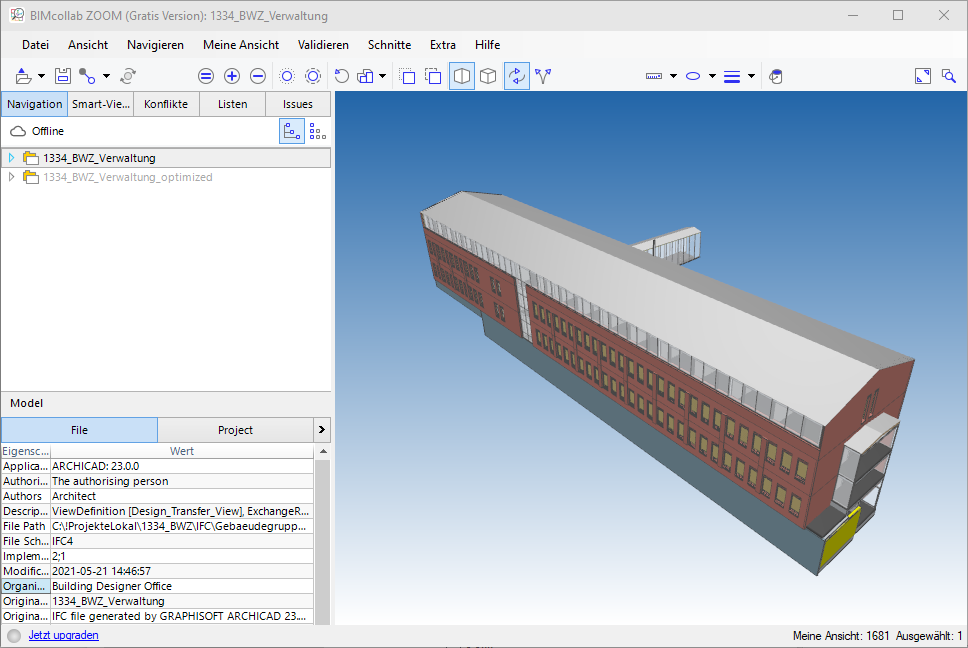

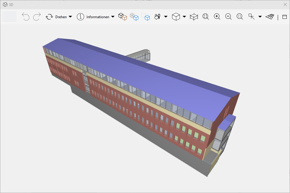

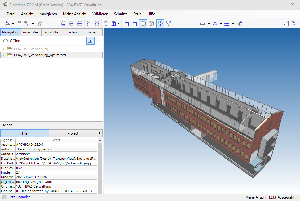

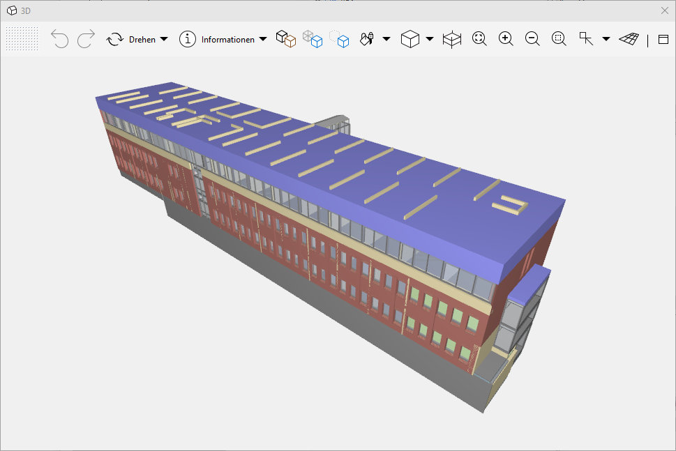

      Hi, some more problems with optimized IFC4 files from Archicad 23.
      Tl;dr: Can’t recommend Solibri Optimizer for IFC4 files 🙂
      Original file in Solibri:
      Optimized file in Solibri:
      Original file in BIMcollab ZOOM (note element count in status bar):
      Optimized file in BIMcollab ZOOM:

            The problem is related to point 1 of my initial post.
            The only viewer (from the ones I tested) still capable of visualizing the whole model is Bimvision.
