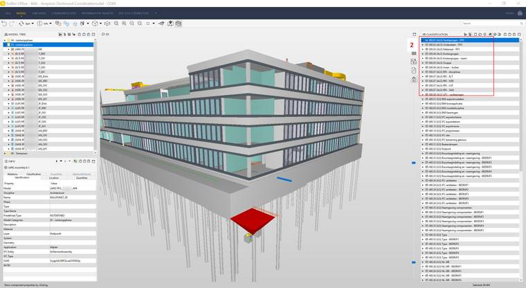

    I have a problem with showing models through the model tree. Some models won’t show if I use the = or +.
    If I classify the model, I can make it visible. So there are elements in the model and I can see them if I use = / + at the classifications.
    Re-opening the project or Solibri makes no difference.
    I have had the problem several times now (not often, fortunately). Earlier in Solibri 9.10, now in 9.12 too.
    The model I’m using right now and showing this problem, is made in Allplan en exported IFC 4x0. But I’ve had other models from Allplan or IFC 4x0, with no problems.
    Hope to hear if anyone else has this problem and knows why it’s happening!

        In the first screenshot, I select the modelcategorie ‘05 - Leistungsphase’ and then =. The first model shown in this modelcategory won’t show.

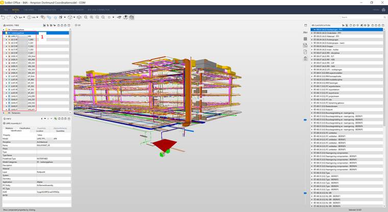

        In the second screenshot, I add a random classification where the same model (the first in the modelcategory) is classificated and add it to the view.
        In this way, I can see the model.
        So summarizing: the model won’t show if I select it in the model tree. But it does show when I use a classification.
