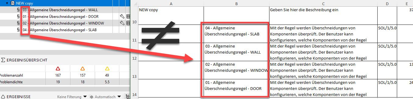

    While I tried to export the reports from the rulesets, I have seen that the order of the rules do not match the rules in the report. Of course, we can reorder the report in Excel or connect the cells with the values, but that should not be necessary.
    While testing this, I have noticed that the rule order/structure or rule name (alphabetical or numerical) do not influence the position in the report, but the report is based solely on the fact when this particular rule has been added to the ruleset.
    this means that once the ruleset is completed or structured, you must reorder the ruleset in a new one, before saving it. Reordering the ruleset and coping it does not work 😉
    or am I missing something?
    here is the problem:

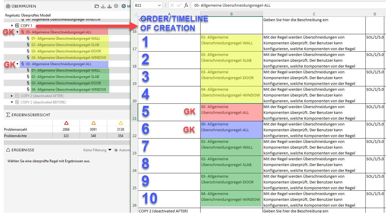

        it is, as mentioned, affected by the Timestamp when this rule was added. I tried to run the test with an activated/deactivated gatekeeper, but the results are always the same.
        If the Gatekeeper has been added after the creation of the other rules, it will appear later in the list.
        The only way around would be to add another ruleset and copy the rules ONE by ONE! in the exact order as you would like them in your report.

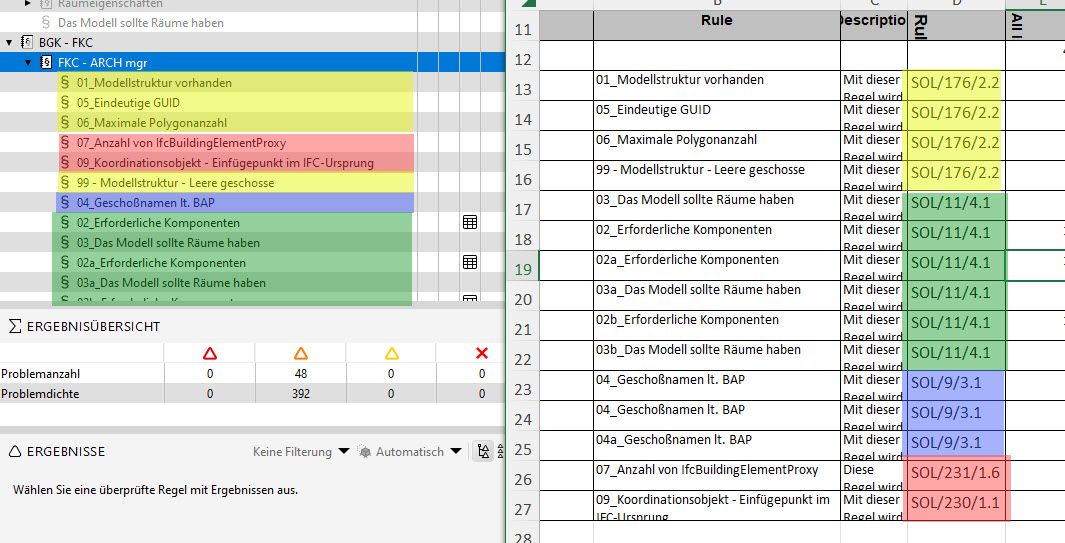

                    I haven´t had the chance to test the “*.csetx”, but this issue reoccured and here are some of further findings on this topic:
                    • the primary property for sorting is the Rule Nr. and when it was created - in my file it was #176, #11, #9, #231, #230
                    • the secondary property is the creation within the range of Rule Nr. - this can be partially influenced/rearranged by dragging the rule outside the ruleset and then moving it again inside
                    here is a picture from the export, where the rules are arranged by rule nr and then chronological:
