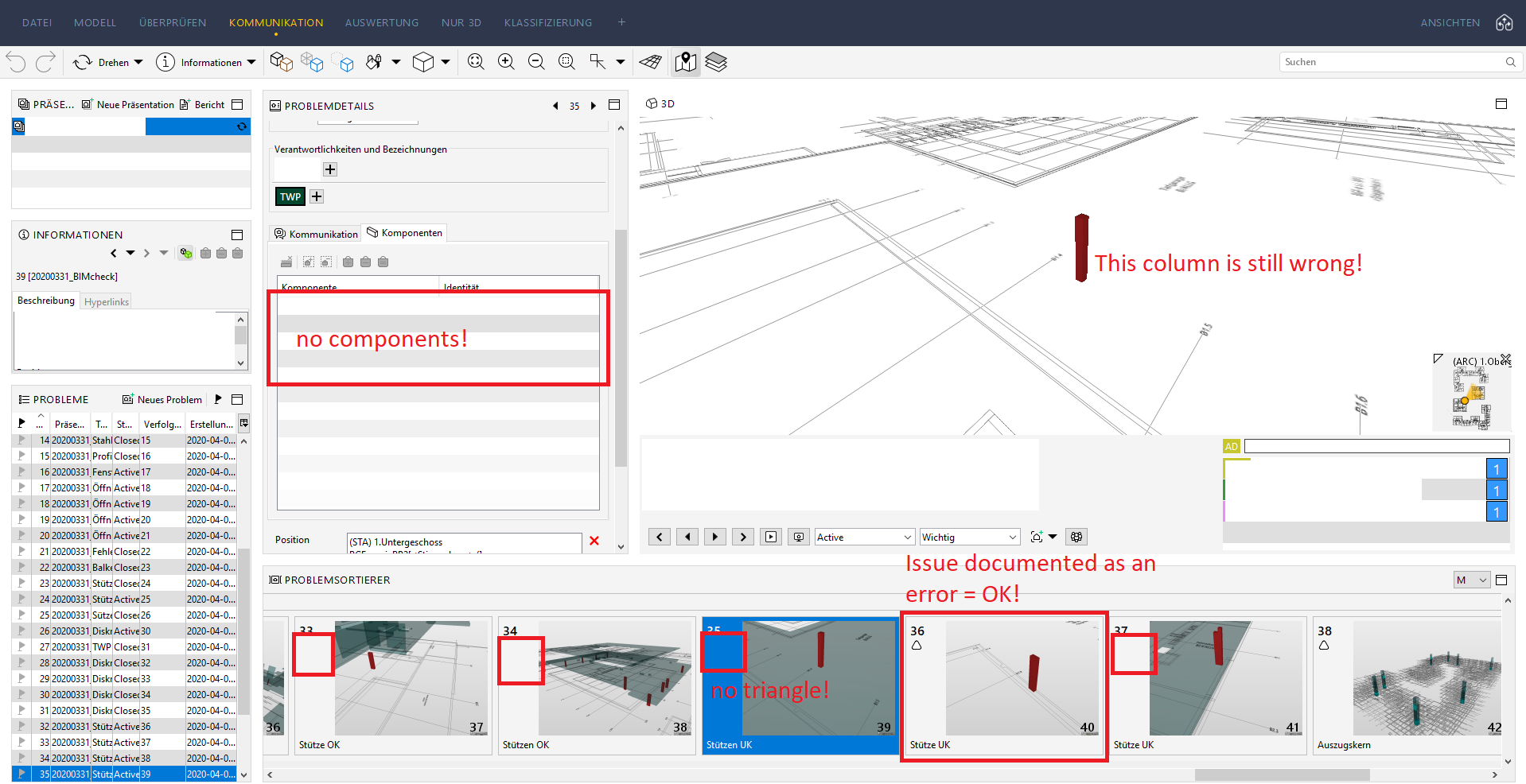

            Below I am also sending you a screenshot visualizing the problem. In my project I have documented (sol/234/1.2) discrepancies between an architectural opening and a proxy element. In the next model update, all issues using this SOL in this presentation lost their connections but the problems are still there.
            The strange phenomenon about this case is that somehow not all issues have been lost but some sort of filtering happened here. There are other SOLs in the check that might or might not have lost this connection. I am still trying to identify why and how.

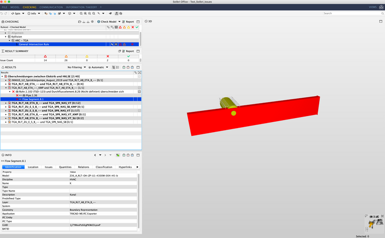

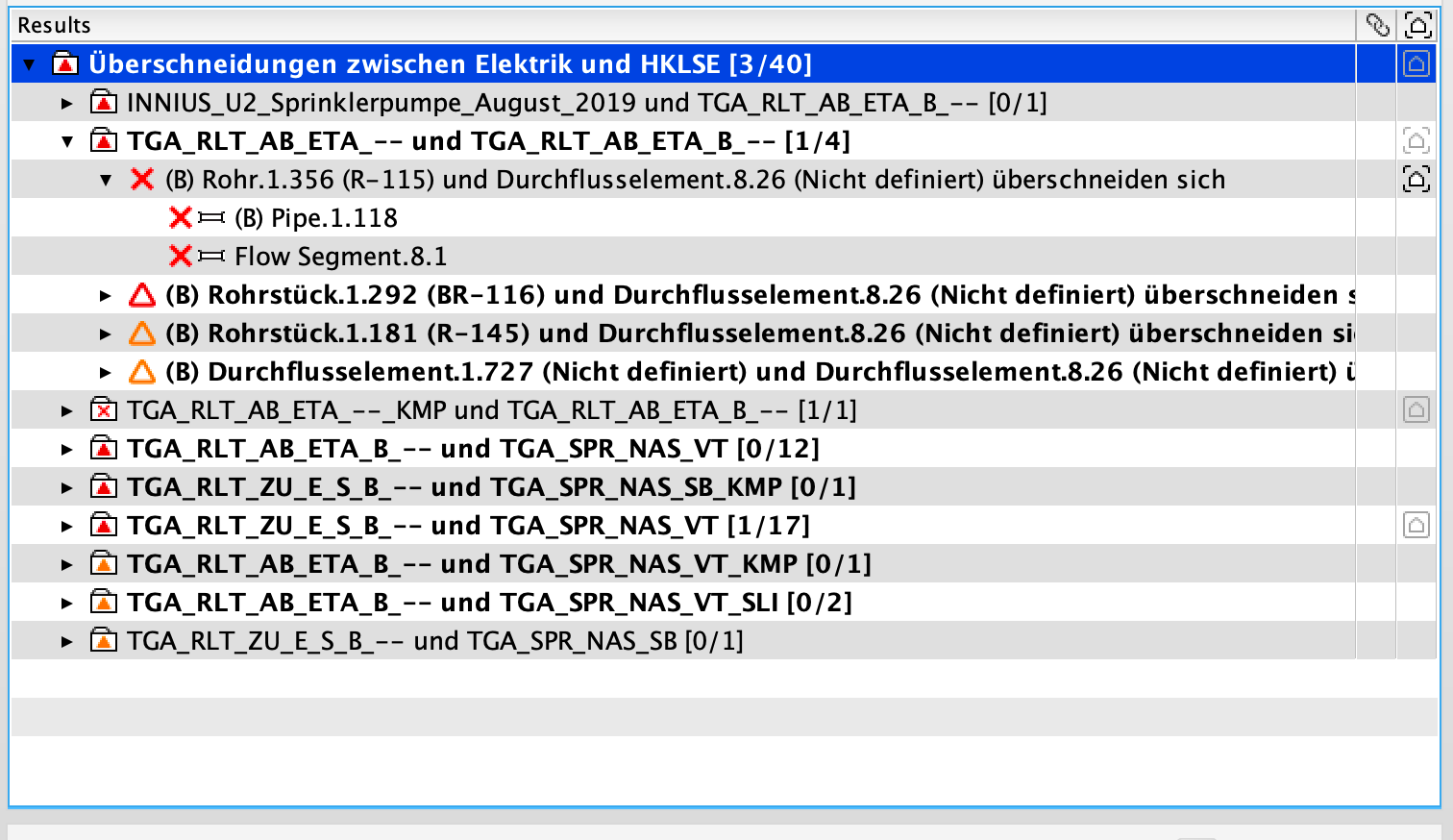

              Here is a screenshot of an example clash detection between to HVAC IFC-models. A pipe and a flowsegment are clashing. I created an issue and a presentation.

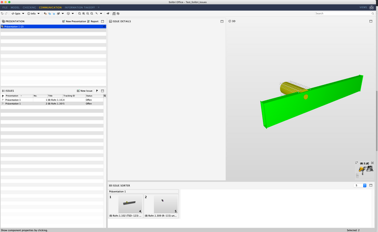

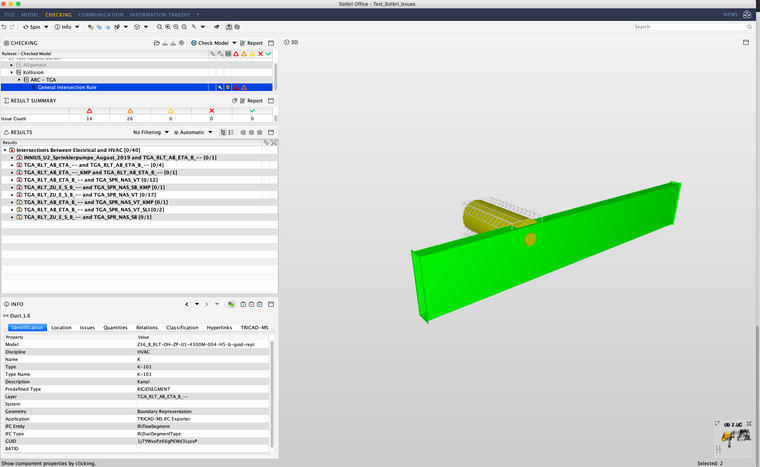

              Now I updated one modell. The clash still exists but the issue is gone (no connection of the issue in the presentation to components and no triangle). The categorization of results changed completely. The component is now called “Duct” although the IFC entity is still IfcFlowSegment.
              The difference between the component in the first an the same component in the second model is the Solibri name “Flow Segment” and “Duct”. The component got an additional IFCDUCTSEGMENTTYPE in the second IFC. The GUID is the same.
              I guess the connection of issues to components and rules gets lost when the TypeClass (https://society.solibri.com/topic/96/visible-ifc-entity) or the IfcName of the component changes – because Solibri then changes the categorization of the results and the issue is gone.

                If component type changes from Flow Segment to Duct or Column to Beam the results are lost in rechecking even the IFC Guid stays the same. This has been always the case in Solibri. Note: also this effects on many filters in rules, classifications and ITOs. The new component type might not be included in the existing filters. The results might change or be missing also due to this.
                In IFC2x3 there is no IFCDUCT entity like there is in IFC4. The component type (e.g. Duct) is selected based on the IFCTYPE entity (e.g. IFCDUCTSEGMENTTYPE).
                I believe that there is two possible cause for the problem that you encountered:
                1. The IFCDUCTSEGMENTTYPE is added the IFC file
                2. Solibri has been fixing issues in the IFC type import and in the earlier version the IFCDUCTSEGMENTTYPE was not imported correctly. Now the new version brings the type in and the component changes to Duct from IfcFlowSegment.
                We will check if the results could be some how preserved in case of change in component type.
