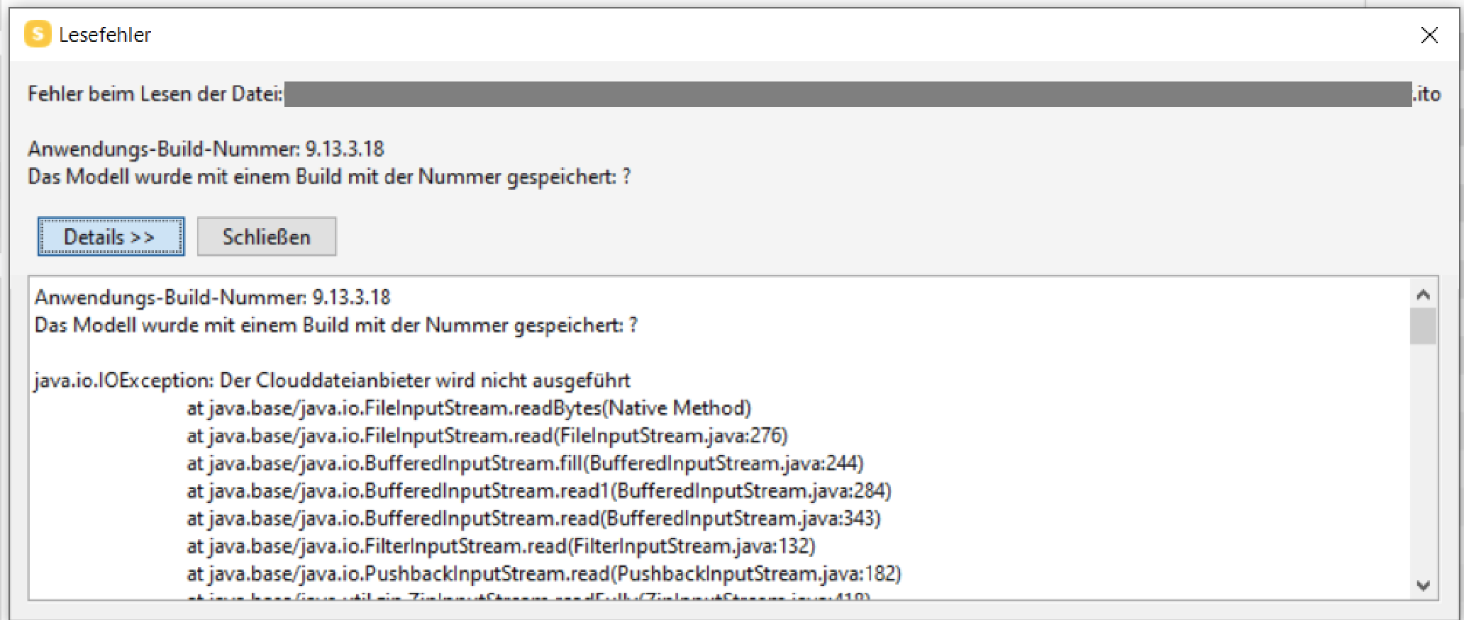

            Actually if new files are getting deployed to the shared location and even sync settings for this location are set to “Keep always available” it seems like that this is causing issues as Solibri often throws the usual file reading error before all the ressources could be loaded.
            Not sure why this is happening, but if it does it is pretty annyoing as then I have to either force close or dismiss tons of warnings to proceed.
