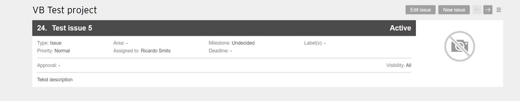

                Regarding the New Bimcollab API, is this the topic where we also could post our feedback?
                We are experiencing multiple problems with this new API. Problems that we haven’t experienced before with the old API…
                • Data loss. When synchronizing to BIMcollab, sometimes data like added text in the description does not get synchronized. (This is random and not easily reproducible)
                • Synchronization report does not display the real amount of changed/new items. (Almost always)
                  For example, when 2 issues are edited and then synchronized, the report could say 21 issues changed. This is the case for import and export.

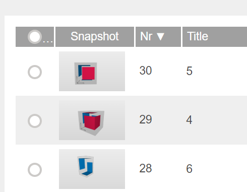

                • The order of issues in BIMcollab is changed when uploading (Random)
                  For example the picture below. The issues are made in order of 4-5-6 in Solibri, but in BIMcollab they change in order. After synchronizing back to Solibri, the order changes in Solibri too.
                • Sometimes slides don’t get uploaded at all. (Random)
                At this moment, we can not use this API because of this poor performance that we experience.
                Do other people also experience these kind of problems?

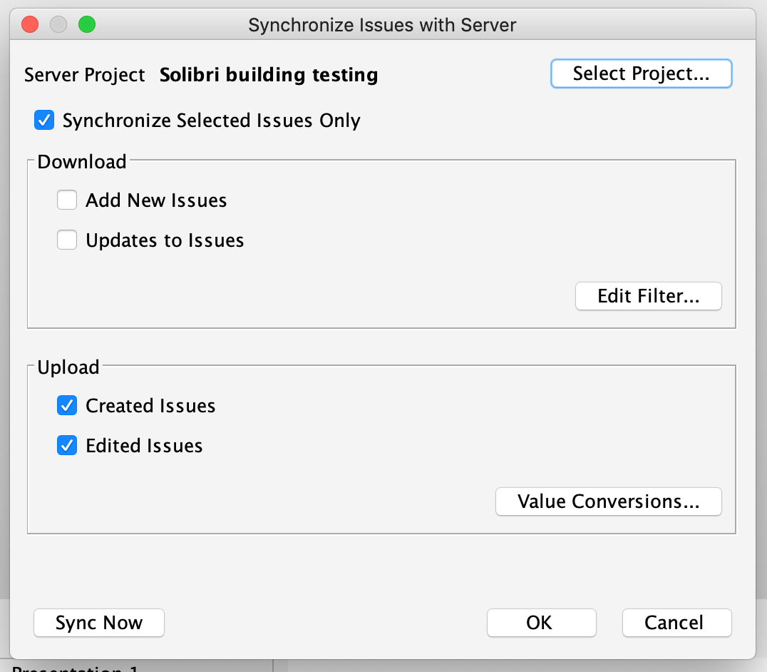

                    Sync report: If I understood correctly, the problem you are facing is that the sync report indicates that all issues have been edited (either up or down). Unfortunately this is the case (and has been) for the sync report, when synchronizing the entire presentation. The sync report does not check individually which slides are changed, but rather indicates that all slides are pushed (or pulled), even if only 1 or 2 have actual changes. One way to currently avoid this, and to have more control over syncing, is to select the issues you wish to upload (or download changes to) and use the “Synchronize only selected issues” :
                    Issue order changes: This is due to the fact that during the initial sync, Solibri adopts the server index numbers. This is because we do not want to impose our index numbers on the server, and instead use just one common numbering. After the first sync, this should no longer jumble.
                    The sync report and issue ordering problems will no longer be visible in the next release (which will contain the improvements to BCF Connector).

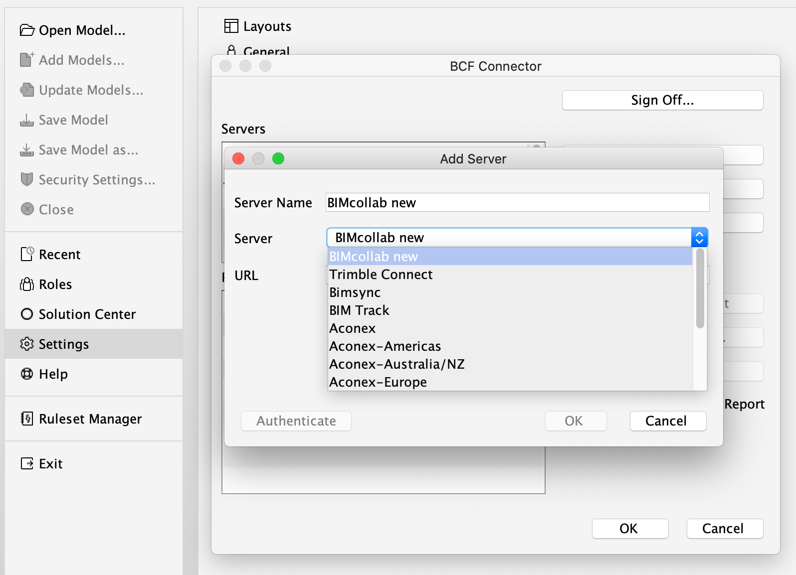

                      As an update on this topic, the old BIMcollab connection has now been removed with the release of Solibri 9.12.0.
                      To connect to your BIMcollab project, select the BIMcollab New connection from now on, and remember to add your project-specific URL when making the initial connection.

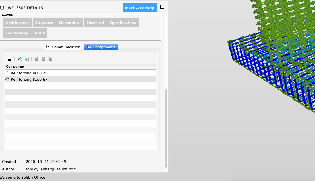

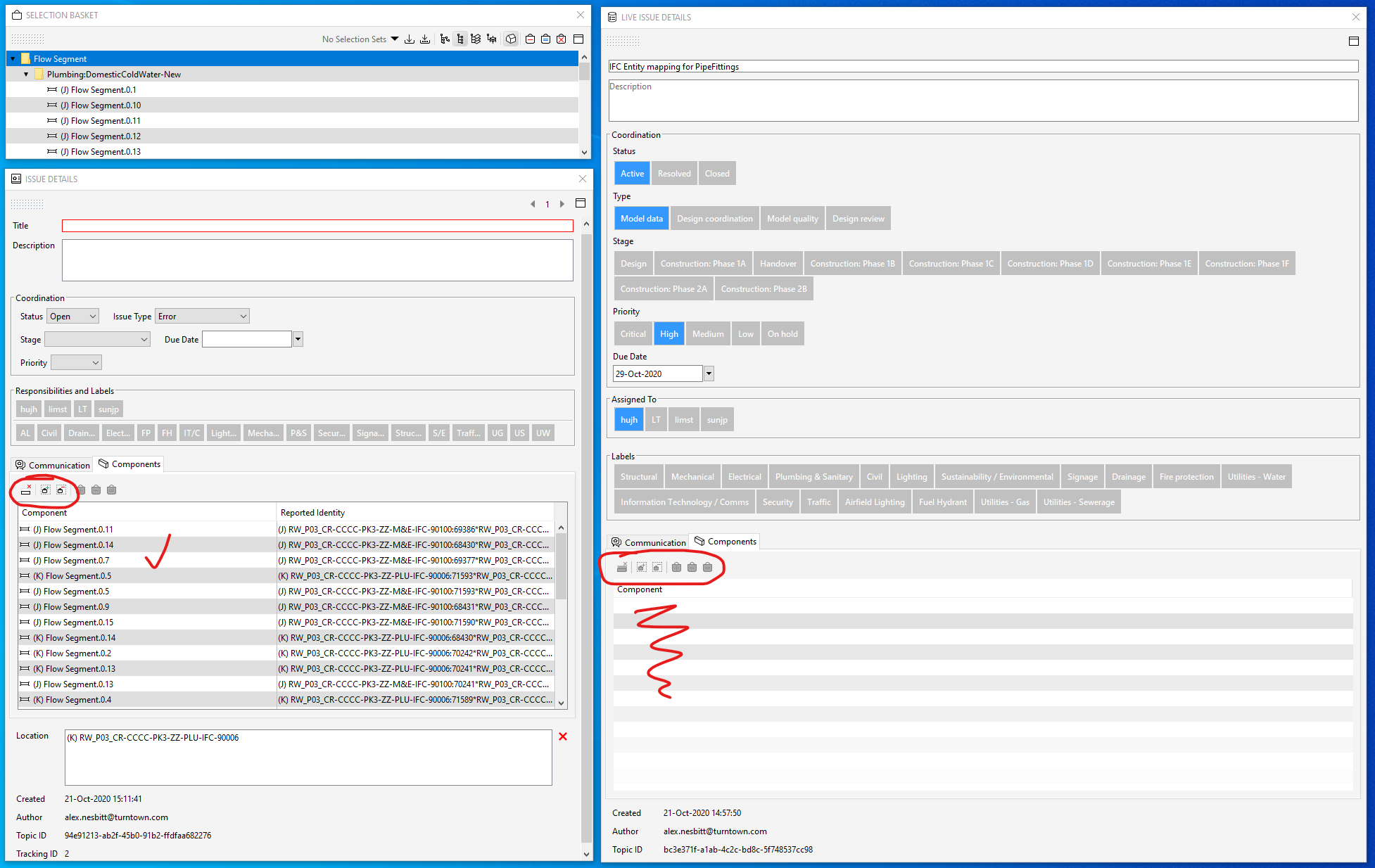

                                    I have spotted a bug with the “Live issue details” not being able to add components to issues from the selection basket. Can still do this in the “Issue details” window though.
                                    • tonigyllenbergT Online
                                      tonigyllenberg Solibrians
                                      #31
                                      Hello @alex-nesbitt!
                                      It’s good to hear about the performance gains 🙂
                                      Without knowing more about this specific case, I suspect the issue about components can be explained by looking into the BCF-API standard. As viewpoints are immutable, once they have been added to a live issue (or e.g. local issues imported to BCF Live) and synchronized, the viewpoint, including components, is no longer editable. This being said, it is possible to add components from the selection basket to the issue until the moment that the issue is synchronized.
                                      A few suggestions which may be beneficial:
                                      1. Using the Mark As Ready button (Settings -> BCF Live Connector -> Use automatic Synchronization-> Off) should solve this case by allowing you to work on your issue details and viewpoints before adding them to the synchronization queue (by selecting Mark As Ready).
                                      In case you do not wish to use the Mark As Ready feature, here are a couple of other suggestions:
                                      1. For importing local issues, make sure the components are added before the issue is imported to BCF Live and synchronized.
                                      2. When adding issues directly into BCF Live, the issue will not be synchronized until a title is added (i.e. viewpoints and components, along with other details can be edited up until a title is provided).
                                      Please let me know if these solve the problem you are facing.
