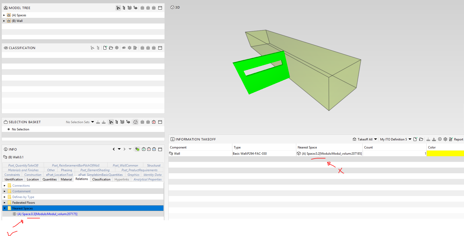

    I add a sample of a wall, showing an incorrect “Nearest Space”. It’s very strange…
    I attach a ZIP that contains:
    • 1 IFC of a wall
    • 1 IFC with 6 spaces
    • 1 SMC with the two IFCs
    Kind regards,
    Xavier Coll
    EiPM
    Nearest_Space_problem.zip

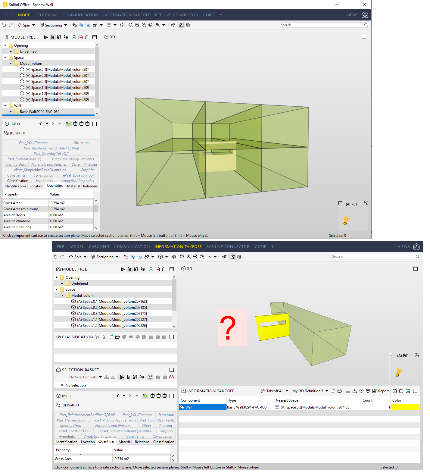

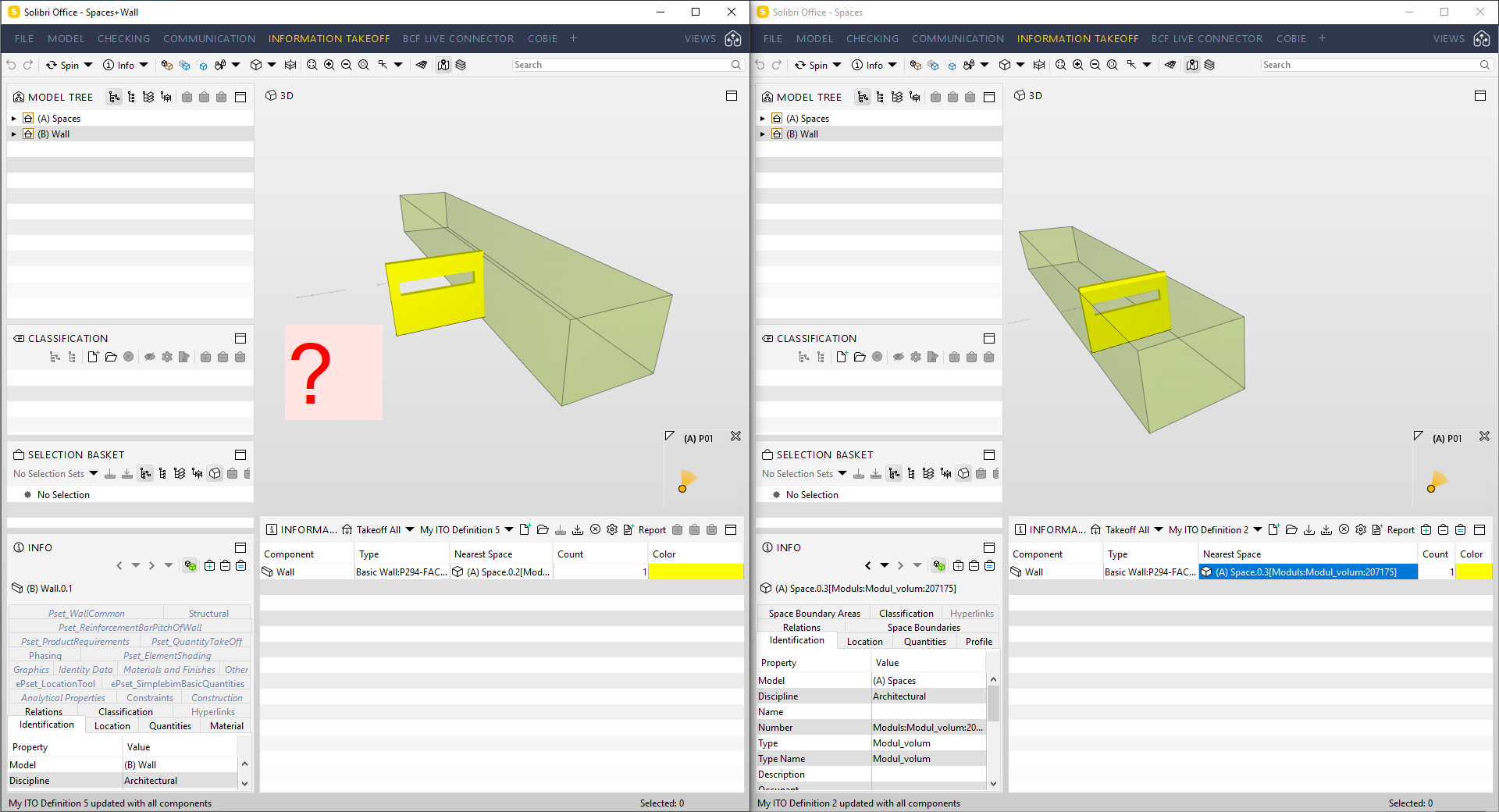

      It’s really strange… the same SMC file opened in different times: sometimes “Nearest Space” works well and sometimes not…
      I attached a screenshot and a video (in a zip file)
      Kind regards,
      Xavier Coll
      Nearest_Space_Problem.zip

            @Xavier You are right, this is strange and confusing.
            To sum it up:
            • Nearest Space (Location) is giving the “wrong” space - but sometimes it could be also right.
            • Nearest Space (Relation) is however working correctly.
