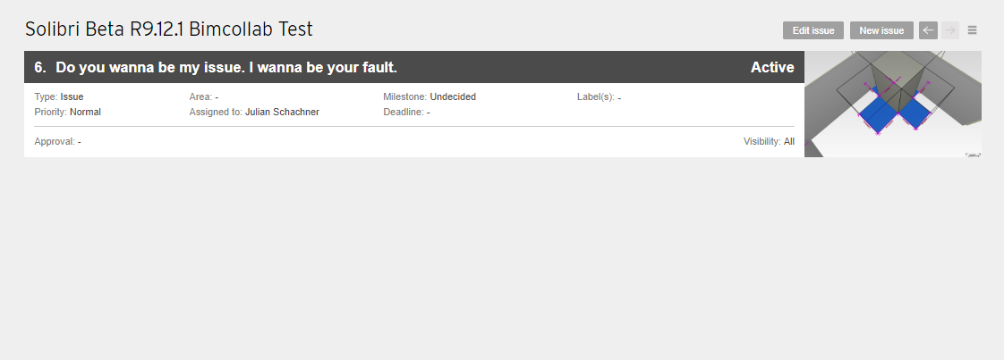

          @xavier said in Solibri 9.12.1: In BCF Live Connector, the screenshots of the new Issues disappear:
          Screenshots dissapear… And this happens with BIMsync and also BIMcollab Live connection…
          Speaking for BIMcollab, I made the experience that when adding a new image to an issue in Solibri, it is necessary to always add a comment or the snapshots will be lost. Try it out. (Btw, this is actually a thing they should write somewhere in big bold letters …)
          This is actually the case when you want to add further screenshots to existing issues - BimCollab says it works as it should. I doubt it. However, I think it should not happen when you create a new issue - will try that out later.

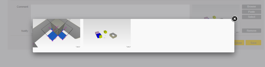

                    • N Offline
                      N Offline
                      Noushed Solibrians
                      replied to Xavier on last edited by
                      #10
                      Hi @xavier,
                      Have you checked if the viewpoint truly get exported to BCF server? I meant in BIMcollab/bimsync server UI, can you see the viewpoint after solibri sync is done?
                      XavierX 1 Reply Last reply
                      • XavierX Offline
                        XavierX Offline
                        Xavier
                        replied to Noushed on last edited by
                        #11
                        Hi @noushed,
                        Yes! I attach a video.
                        Kind regards,
                        Xavier Coll
                        EiPM
                        video.zip
                        JSNJ N 2 Replies Last reply
                          replied to Xavier on last edited by JSN
                          #12
                          That’s also good to know.
                          When you do not add a comment …
                          … it wont be visible in the history (as discussed above) …
                          … but you can select it here manually?
                          So it indeed get’s synced, but BIMcollab does not want to / or cannot show it in the history itself? For me this makes no sense.
                          N 1 Reply Last reply
