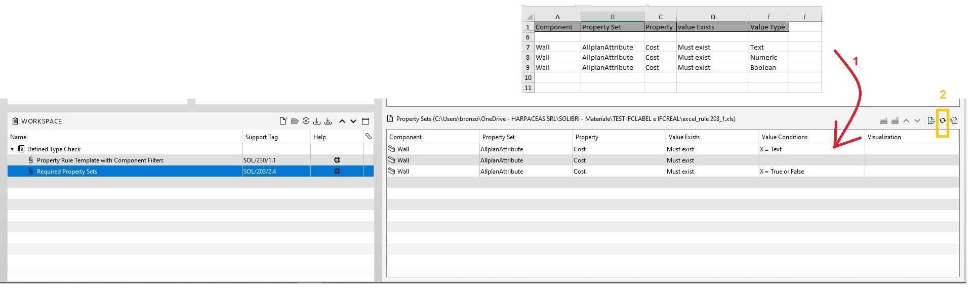

          @JSN I did some tests with an excel worksheet formatted as shown below … but I can’t get the desired result.
          @Solibrians is there a guide on how to write the excel file so that all the possible values are read by the rule?

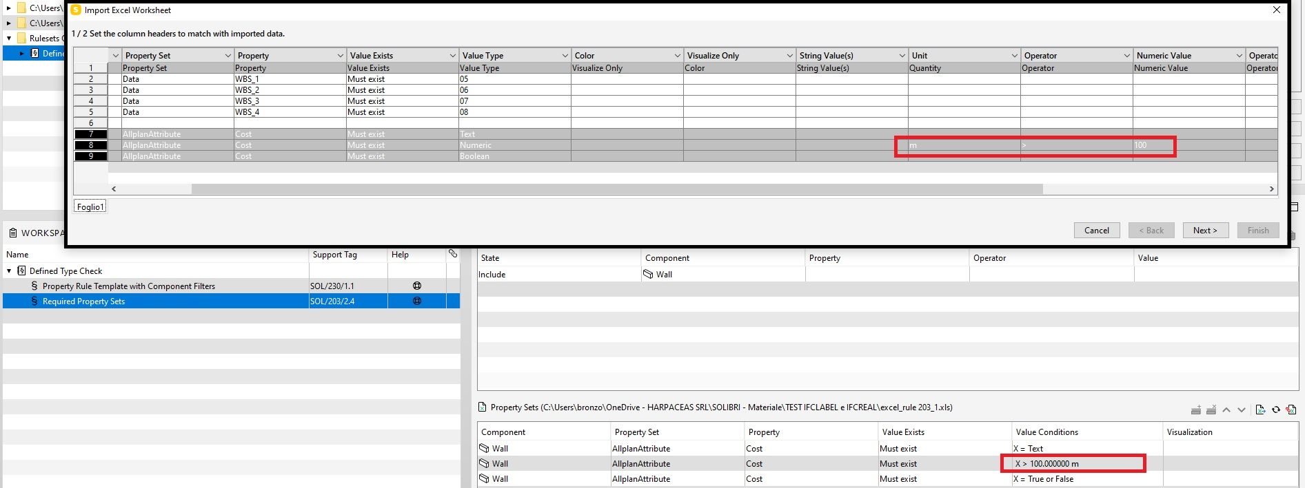

                @paola-bronzo
                Did you make sure the headers are all matching - at least when using units like m or m2, the full line should load correctly and then you are able to update …
                  #10
                  @lasse-lindqvist
                  With Units it’s working as shown above, but what is the secret symbol for no unit now?

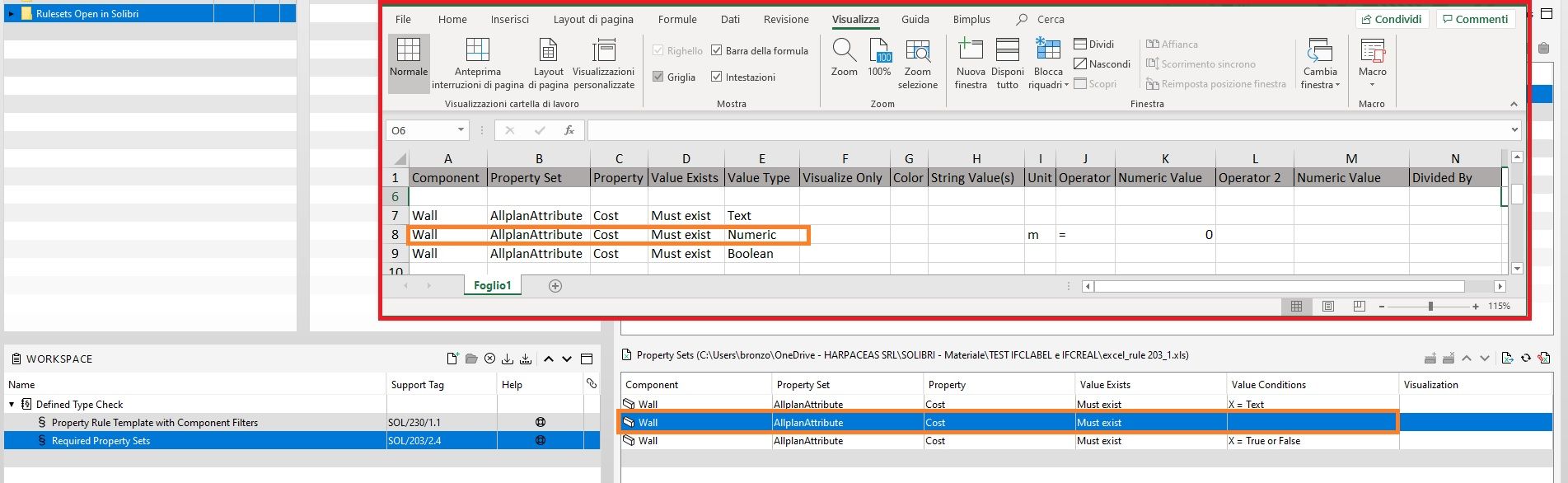

                  • paola bronzoP Offline
                    paola bronzo
                    #11
                    @jsn Thanks ;)! Now It works!

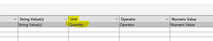

                      In the meantime, a note about consistency and UX, as your table brought light into another very confusing thing.
                      @Solibrians Why is the import drop down menu header called “Unit” whilst in the UX dialog it’s clearly labeled with “Quantity”? This is confusing. Probably just a legacy thing, but still.

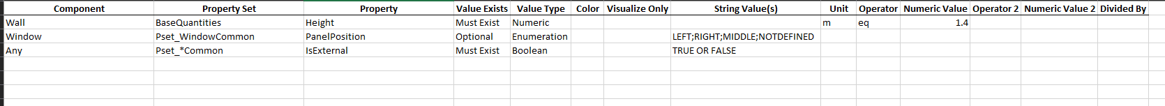

                              #16
                              @chris
                              No guide. Try to use this as an example:
                              C:\Users\Public\Solibri\SOLIBRI\Samples\data\Required Property Sets.xlsx

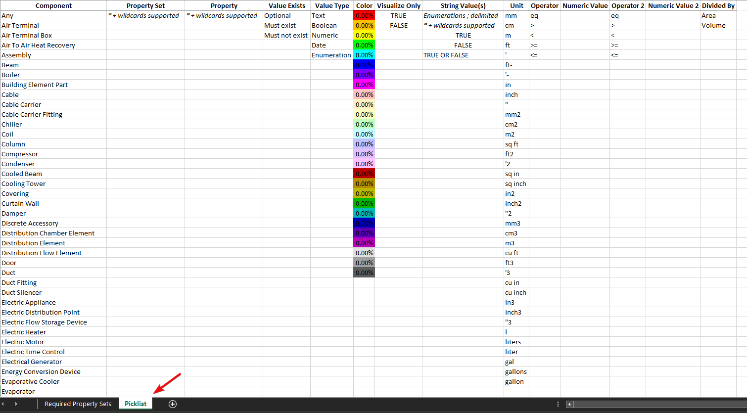

                                #17
                                @chris
                                Here is a XLSX that has a picklist/cheatsheet that you can use to copy/paste cells from to your required property sets sheet along with providing hints:
                                Required_Property_Sets_Picklist.xlsx
                                Some things things to note:
                                • You can use asterisks and question mark wild card characters in your pset, property, and property values.
                                • There are many ways to specify units (even gallons for volumes), and it should convert to your File > Settings > Units that you have set.
                                • To set the True, False, True or False value for a boolean property, it goes in the “String Value” column
                                • You can use any color you want (the picklist has some standard ones), and the percent is how transparent. NOTE: XLS will limit the colors so its better to use XLSX. NOTE: You see the colors in the Rule Tools.
                                • Use a semicolon to separate an enumeration.
                                • For the equal numerical operator, use ‘eq’. You can NOT use equals sign (=), though you can use >= and <=
                                Example : 5a8aaddc-d923-4a8f-a13d-b54bec3bc27e-image.png
