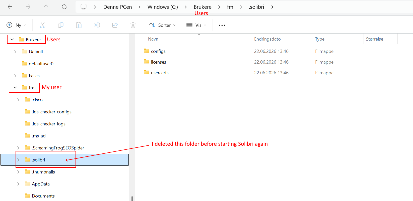

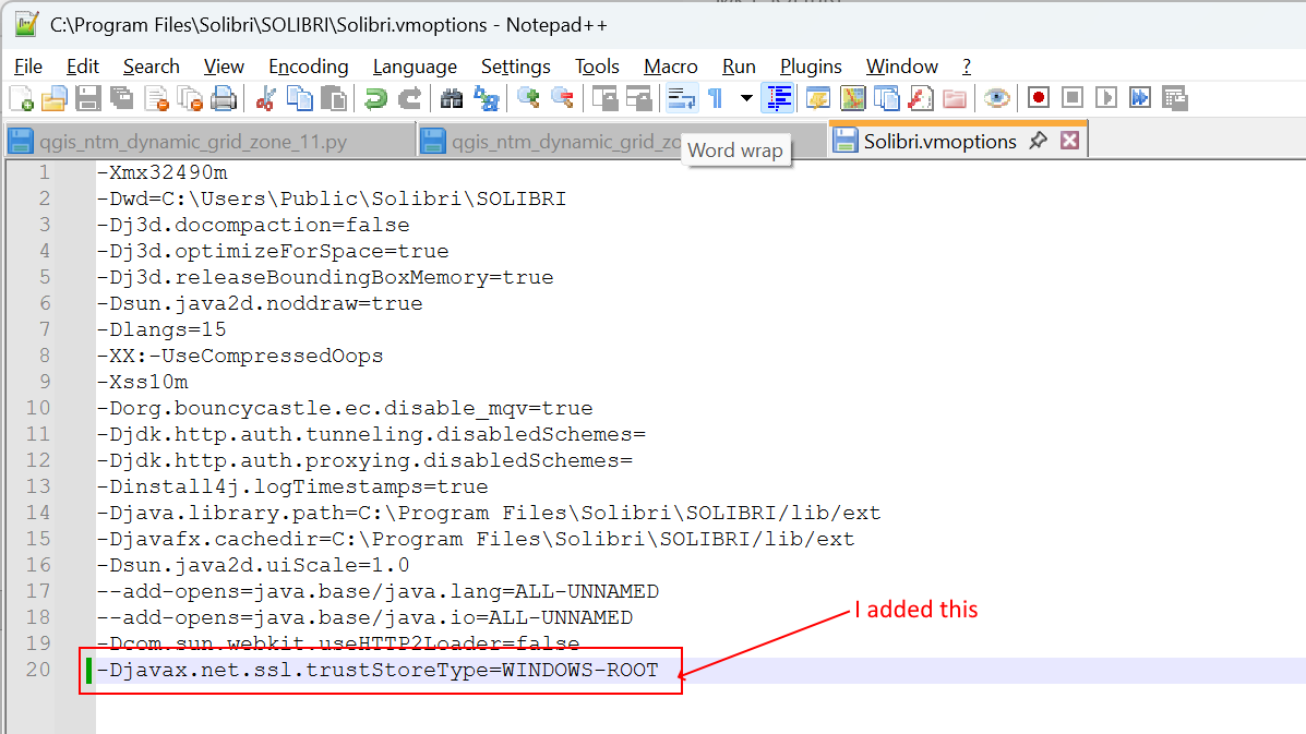

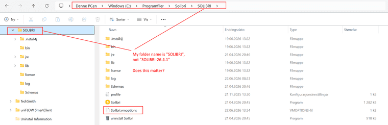

                      @Matti I tried the following:
                      (1) Deleted the folder c:/brukere/fm/.solibri (“brukere”=users in Norwegian Windows version)
                      (2) Tried to start Solibri - Browser says “You’re logged in” but Solibri still has the same problem
                      (3) Added -Djavax.net.ssl.trustStoreType=WINDOWS-ROOT to folder C:\Program Files\Solibri\SOLIBRI\Solibri.vmoptions (REMARK: The folder name by me is just “SOLIBRI”, not “SOLIBRI-26.4.1”, does this matter??
                      (4) Started Solibri again - same problem
                      (5) Did BOTH point (1) and (3) again, and then started Solibri - still same problem.
                      Screenshots:
                      abe319e2-bd6e-4067-8e98-50feb7877e96-image.png 5d51e809-1e2d-4e96-9c0a-fc405eae705e-image.png 2c7e6627-d6e6-4677-b33e-8637a6482d2a-image.png
